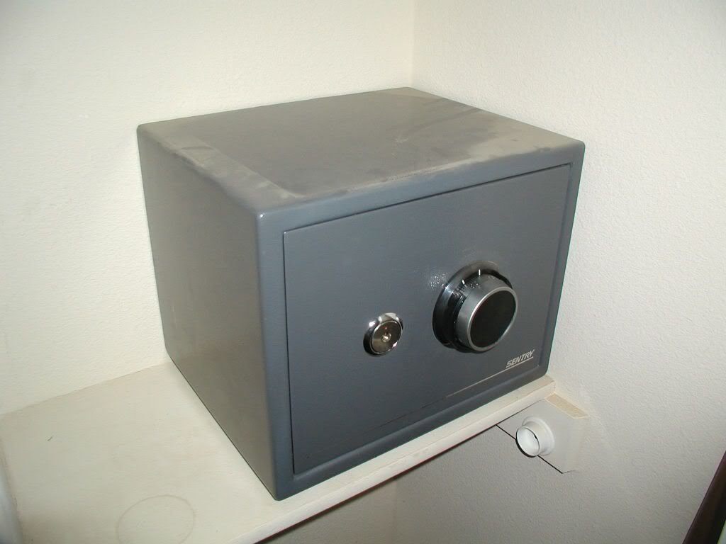

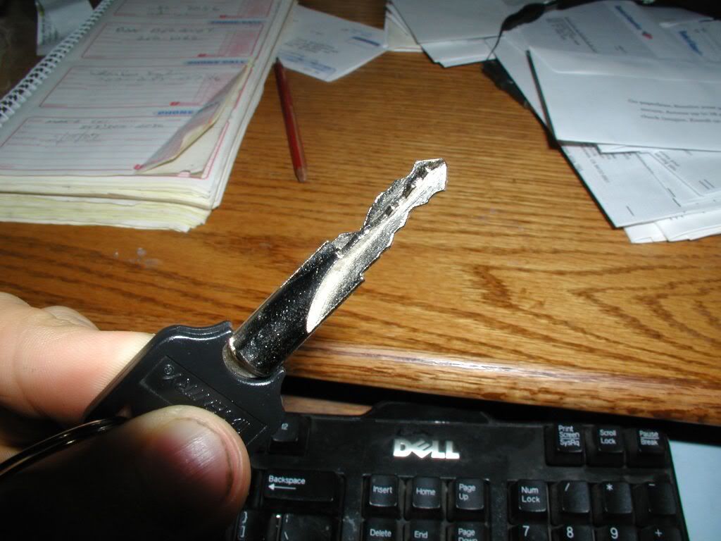

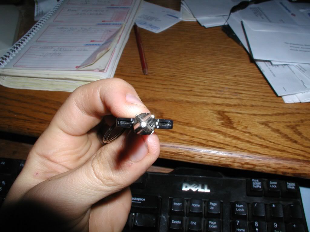

this is my safe: it has a 4 number combo (reverse for some reason) and a keyhole that is like 24 pins (4 way key, 6 pins on each) not sure if they security or not, but picking isnt something i can do.

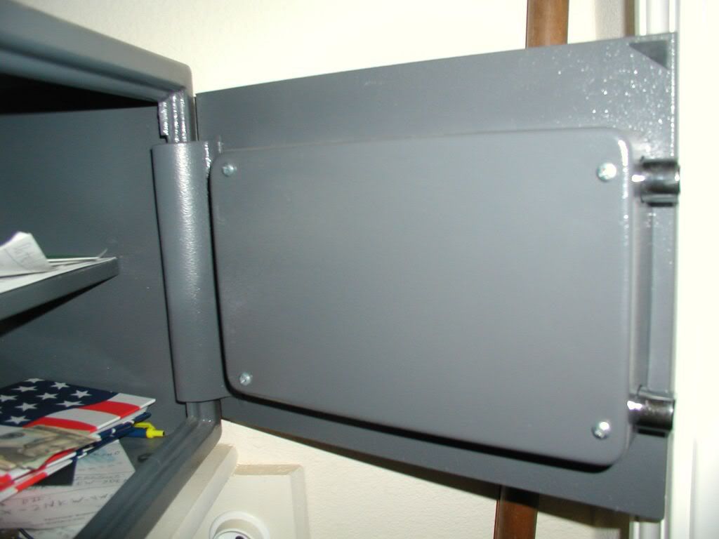

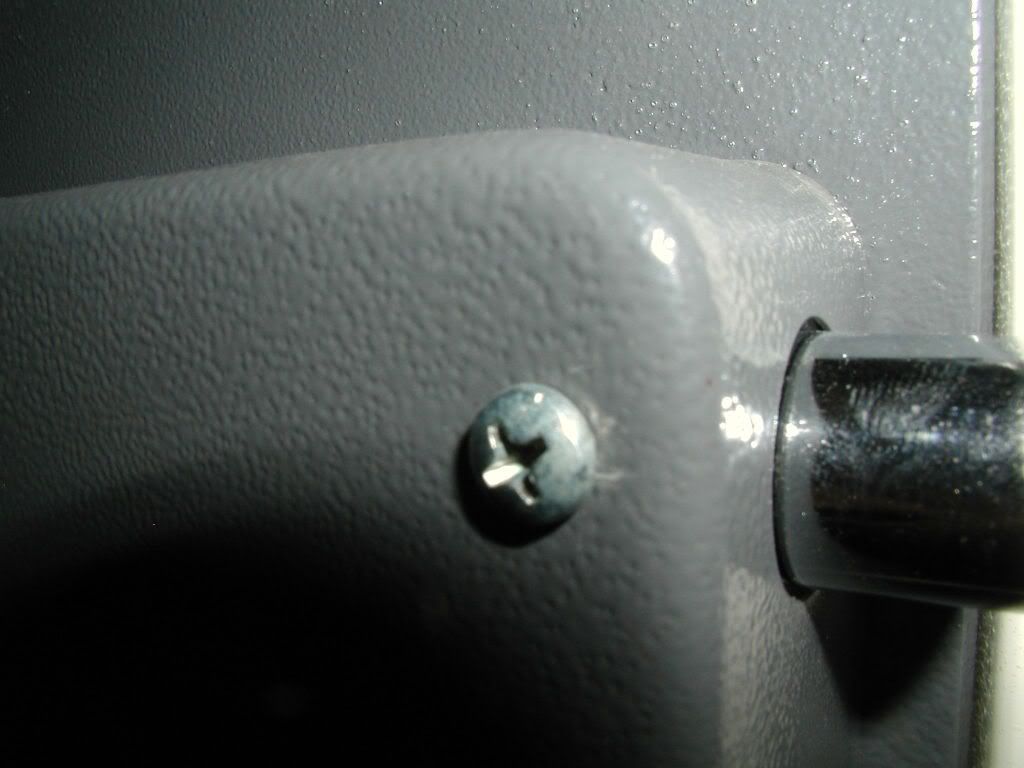

so, you see the screw in the 4th picture? there are 4 of those (look at 3rd picture) on the back of the opening.
im thinking if i take those out, i can take the back off, and look at the mechanisms...would be a great learning experience, and i could make a cool vid out of it.
do you guys think its a good idea to take it apart? is it risky to the safe?

Postby Tempature » 23 May 2007 22:56
ya i know what you mean.
i tried with a regular hand held screwdriver, and it wudnt budge at all, im thinking that i would need an electric screwdriver, and that could be really risky to the safe.

Postby freakparade3 » 23 May 2007 23:10
Tempature wrote:ya i know what you mean.
Most electric screwdrivers are absolute junk. You can get more power by hand. Try a high torque drill with a screw bit.

Postby Jryanruch » 24 May 2007 0:12
Take the back panel off and look at the wheel pack. No harm done. There isn't even a relocker connected to that panel. If you thread the wheel pack apart - make sure that you decode the comb (if you put the wheels back in the wrong order) before locking it up. The gates are super wide so you won't have to worry about being accurate with your numbers. Just be within 4-5 numbers on either side of what the comb should be. You can try changing the comb by repositioning the flys on the wheels. Bon Apetit!

Postby triplezero » 24 May 2007 1:59
Your lock (not dial, the pin tumbler) has 16 pins, not 24.
Just thought i would correct you :wink:
