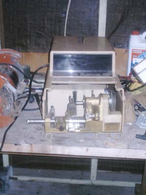

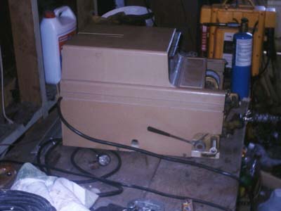

Ok Here are some pics on my server.
here is the front and side with the big plastic cover on.
http://www.albert-cordova.com/key/front.jpg
http://www.albert-cordova.com/key/side.jpg

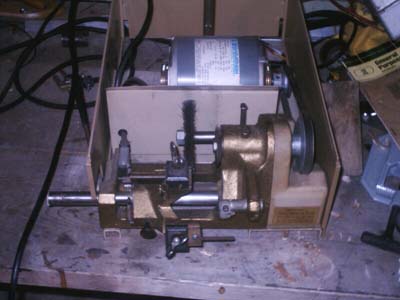

This is the innards with the cover removed.
http://www.albert-cordova.com/key/coverless.jpg
If you need any more details please let me know, My first key off the machine dont quite work. It opens my shed door but I need to wiggle it around to make it work. I think the machine needs a little ajustment? Or I am not doing something quite right?

Postby unbreakable » 30 Aug 2007 18:21
Yeah, it could be off 2 ways it the key semi works.
If you have to wiggle in and out, the shoulder guide may need ajusting, although most are fixed, or so I think.
Or, if you wiggle up and down, the depth could be off (more likely I think). You need to make sure the wheel and the tracer both are in line so to speak.
Without dedicated keys to do this (these keys are a flat key, with no warding, and a single 9 cut, and come with some machines), you can put two blanks into the clamps, and rest the cutting wheel onto one of the blanks. Adjust the tracer until it touches the blank as the cutting wheel does, with no gap between the tracer and the blank and without lifting up the cutting wheel off the other blank.
A closeup of the tracer assembly will get you further direstions on how to make this adjustment :wink:

Postby keysman » 30 Aug 2007 18:37
Curtis 2000 automatic
Curtis+2000+Repair+Manual
http://lockshop.us/Curtis+2000+Repair+Manual.pdf

Postby rescueguy » 30 Aug 2007 18:55
Wiggling the key up and down gains entry.
I have identified the EA-3 blanks from the bucket full as the correct blank.
