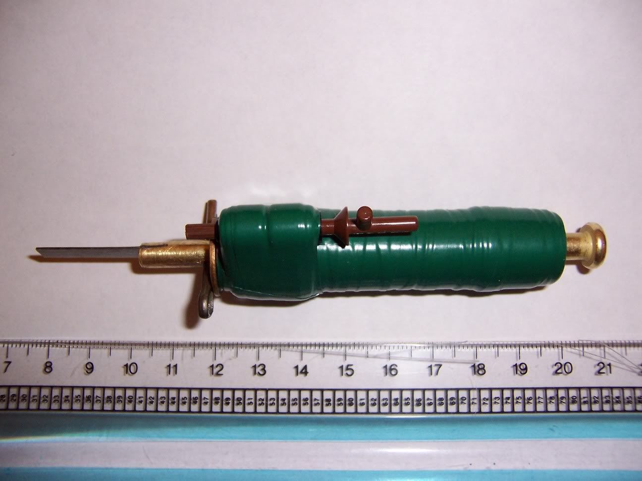

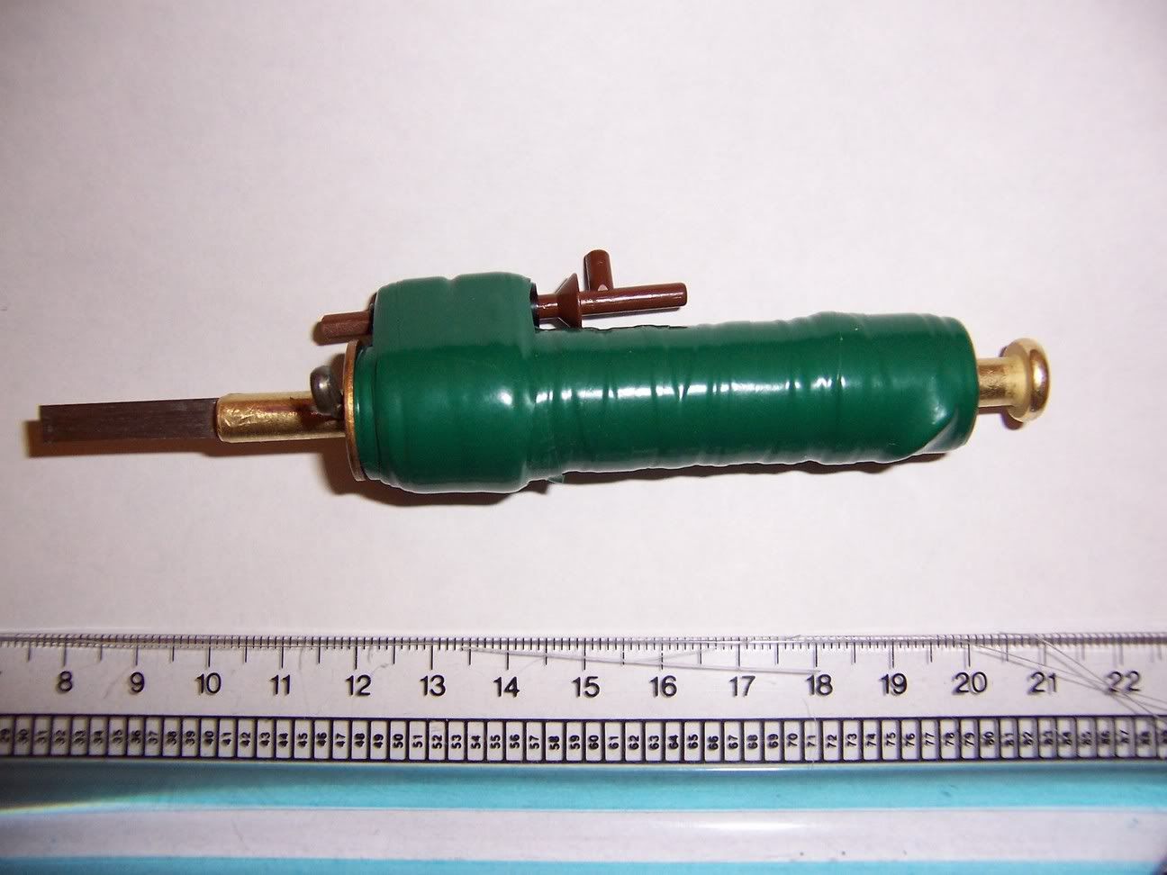

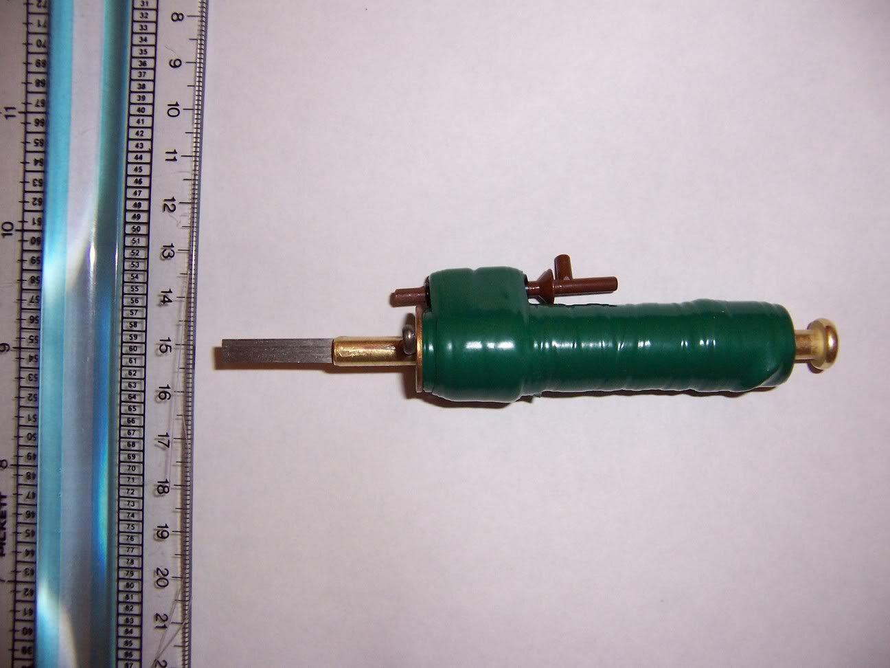

Well I decided to make a plug spinner after seeing an A-1. I do not really need it yet but I thought It would be a good use of time while I waited for someone to get off the lathe. So i grabbed a stub of copper pipe, a cotter pin, a spring, a door hinge pin, and two nuts. Then when I got home I decided I wanted it to have a release so I could wind it before picking so I used some legos and some more electrical tape...Yes legos....
Let me know what ya think.

Postby maldotcom2 » 14 Aug 2004 23:42
That looks absolutely wonderfull!! :D excellent job, how does it work? :D

Postby maldotcom2 » 14 Aug 2004 23:43
let me rephraze that, how well does it work?

Postby thertel » 15 Aug 2004 0:42
Amazingly I just fixed a problem and removed the legos and replaced them with a small rivet piece. I realized that I inadvertently made a button on the back end that I can press to release the spinner. so now all the rivet does is hold it in place till i press the button.
As for how it works, well I had a chance to try it today and it works very well. I'm thinking about making another one out of aluminum tomorrow s that it will look nicer and not need to be taped to hide the terrible finish on the copper I used. I guess I'm just picky about how my tools look.
Next time around I'm gonna take pictures step by step as I make each piece and assemble it.
Thomas
