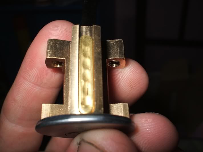

Hi, i brought the lock yesterday and the locksmith assured me that the plate holding the pins in was very easy to remove....well i cant get it
Is it supposed to come off? will it go back on?
thanks for the help i looked around but couldnt find anything
its an abus lock

Postby bumber » 2 Feb 2008 22:27
Those all sound like SC and KW locks you guys said, the lock in the pic looks like it can only slide out, no bending needed but it looks like it has dimples on it that would kill the springs if slid out...I could be wrong because Ive never taken these apart either, but looking at the picture this is what Id think...why are you wanting to remove the clip for cant you use a plug follower, I would imagine you are repinning but if you had to replace springs I couldn't help(also if you use a follower you can only replace the bottom pis :? )

Postby Raymond » 2 Feb 2008 23:46
Hey bumber,
The indentions on that pin retainer were probably not intentional. The piece of curved flat aluminum, brass or mild steel was pressed on and flattened out by the pressing. The indentions are just where too much pressure pushed them into the pin holes. Some brands of locks do have one deeper hole to prevent the retainer from sliding out.
I very rarely have to remove the retainer. You are somewhat correct that it is much easier to use a plug follower. And yes, you can change out top pins and springs this way. Just remove the cylinder retainer, use the key (or pick or shim) to take the plug out. Reload all of the springs and pins with tweezers. After a little practice it becomes very easy. I would rather do this on a kwikset than pop the retainer.
