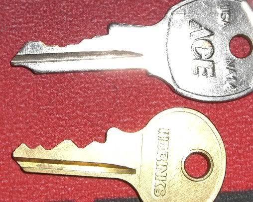

Postby WOT » 15 Jun 2008 18:15
Ok, so here is what I mean:
I believe the right cutter for both of these keys is HPC CW-1011 or Framon FC 8445 which is a thin cutter to allow for smaller clearance between the first cut and the shoulder.
The top one is a mailbox key for an apt complex I used to live at one point. The very front is actually supposed to be completely flat. If you look at any original mailbox keys, you won't see a hump on the front.
The bottom one is a M1 padlock key.
If you do a plunge cut, you'd end up with a key with steeples like the M1. If you make a mail box key like this, it will work, but the steeples will accelerate notching wear on wafers and this can be a big deal for frequently used locks like a car ignition cylinder.
You operate the Framon machine by setting depth and width, then you plunge the cutter forward with a plunge lever, so it is going to be awkward to do smooth transition (holding down the lever with one hand and crank the spacing crank)

Postby mcm757207 » 15 Jun 2008 19:33
Wafer lock keys and pin tumbler lock keys are cut using the exact same process, it's just that sometimes (usually), the spacing between each tumbler is closer on wafer locks because wafers take up less space. Because of this, the cutter cuts into the next cut's "hill" that you are seeing. The hills are a valuable part of the bitting cut on the key blade because they inhibit the key being pulled out in a position where it isn't meant to be.
