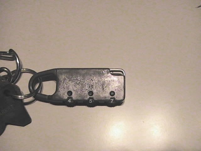

Simple luggage locks are pretty weak. Even my 6 years old little bro opened the lock in the picture when I told him that its right number when you hear loud *click* :D
But noe I can open it so easily since its so old and worn out :(
freakparade3 edit to fix link
Pikku_Allu
Posts: 5
Joined: 29 Aug 2007 13:10
Location: Finland, Jämijärvi
Postby Pikku_Allu » 22 Aug 2008 14:47
erherm.... looks like its impossible to edit your comments...
eat this url then >:D
http://s242.photobucket.com/albums/ff139/Pikku_Allu/?action=view&current=PIC_0171.jpg
