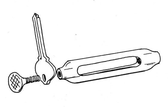

You want to do this cheap, quick and dirty?
Buy a turnbuckle, and a thumb screw that fits the turnbuckle. You may need a washer or two for those keys that don't have round holes.
Look around in your local building supply place, and you will find them.
Looks something like this:
Happy impressioning.

Postby Mad Mick » 18 Aug 2004 17:37
You could also use a small G clamp, such as a carpenter would use.

Postby S3rratedSp00L » 18 Aug 2004 18:18
Great turnbuckle idea. I'm gonna try that... My hand always hurts after I do any impressioning.. I never liked vice grips, but Varjeal's idea sound good as well! Using your bare hands can be painful if you impression a lot.. The gripping tools give you better torque, better control of the key, and mainly less pressure on your hands to make them ache. :)
The commercial tools are overpriced, but they do work pretty well! If you do a lot of impressioning the price starts looking a little better! ;)

Postby HeadHunterCEO » 18 Aug 2004 20:06
Romstar wrote:You want to do this cheap, quick and dirty?
Romstar
thats a cool tool right there
