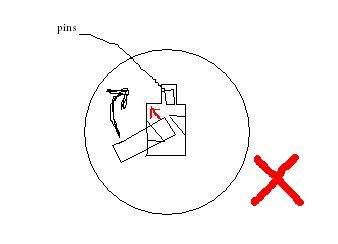

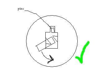

I have similar problems with some locks using even my smallest tension wrench. I found the solution though and that solution is quite simply light tension. But here is a poorly made diagram to demonstrate what im talking about.
This is what you would normaly do (or at least I do)
Here is what you need to do.
I could be horribly horribly wrong, but this is what I do =/
Hope this helps

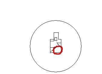

this is what my lock looks like ( i know this is a BAD pic lol )
when i put my TW into the red circled area, i cant get it in a good position, same with the top left portion. sometimes i can get it to hold on the left side but it slips sometimes because il push it down with my pick by accident.
yes i only have trouble doing it to the right, the left fits fine.

my bad, that picture wasnt accurate, heres another.
in the first picture, if i put the tension wrench on the right side of the keyhold pushing downwards, it slips into the bottom area and gets no tension

im sorry also in the first picture, that little red arrow shows where the TW goes when i apply force, once its up there its in the way of picking
