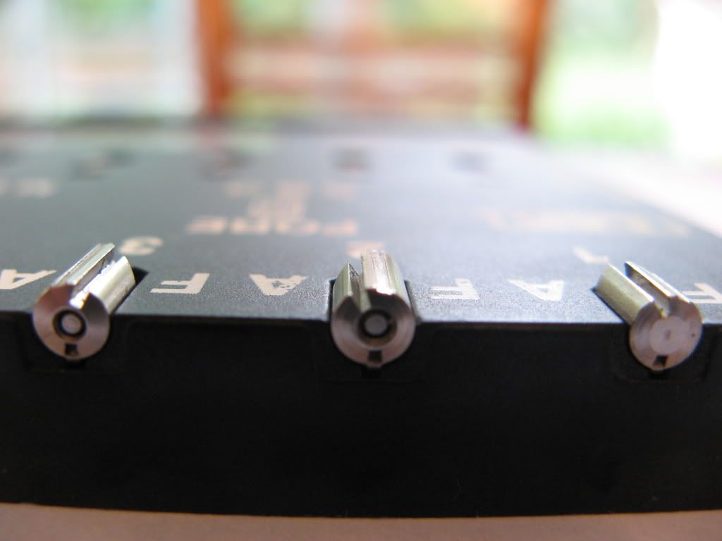

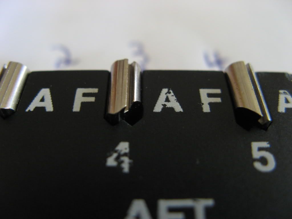

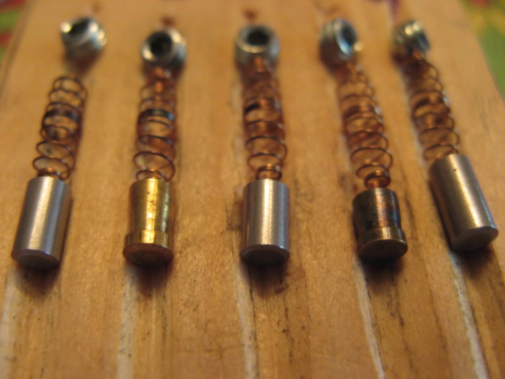

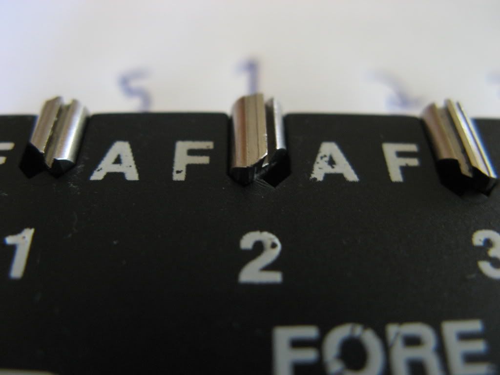

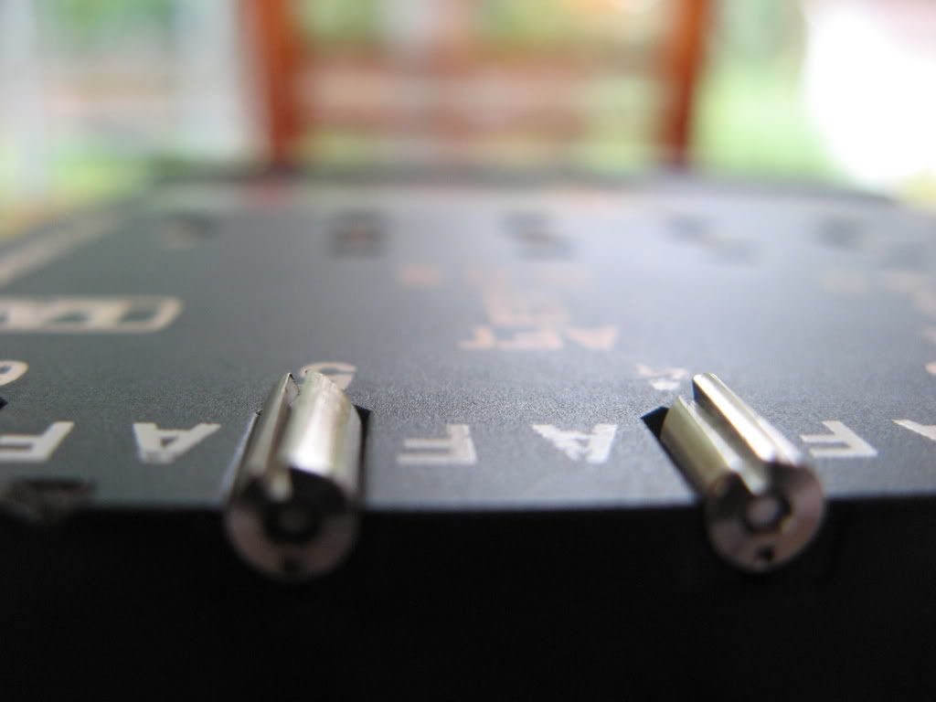

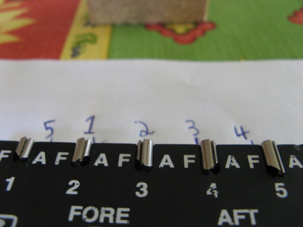

Postby Squelchtone » 28 Sep 2008 10:41
Ok,
I believe your pinning is
2Q 3M 4Q 5S 1Q
(no need to put A or F, as the KBQ and MDS will be enough to tell you which group the pins are in.)
I noticed you put 3D (which would make that a Center pin), but in the pic it looks like a 3M (or a Left angle pin.)
here's a chart from a Biaxial service manual, you may find it helpful when decoding with that LAB device.
To answer your question of is it possible to only have Q and S pins, sure, but as you see, after decoding, you have a nice sprinkling of Q, M and S.
nice pics btw, and I hope MBI checks them out in case I made an error in judgement on that 3M vs 3D pin.
