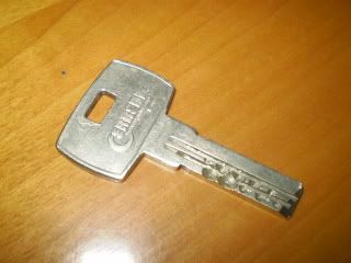

Postby kostassk8 » 12 Nov 2008 16:33
the key i want to copy is a diple key
kostassk8
Posts: 56
Joined: 23 Jul 2007 16:47
Location: GREECE
Re: How to make copies myself
Postby barbarian » 12 Nov 2008 21:27
I don't think you will be able to copy a dimple key without special tools.
You would need some accurate measuring tools and a milling machine at least.
The problem is that the depths of the dimples is very important. You could not get this with a hand drill. The spaces between them are critical also. A milling machine can hold the tool exactly where it is needed and make the cut to the exact depth. We are talking the thickness of three pieces of paper for some of the keys. If they were wrong by more than that amount, they would not work.

Postby kostassk8 » 13 Nov 2008 7:30
Image'
this is it
