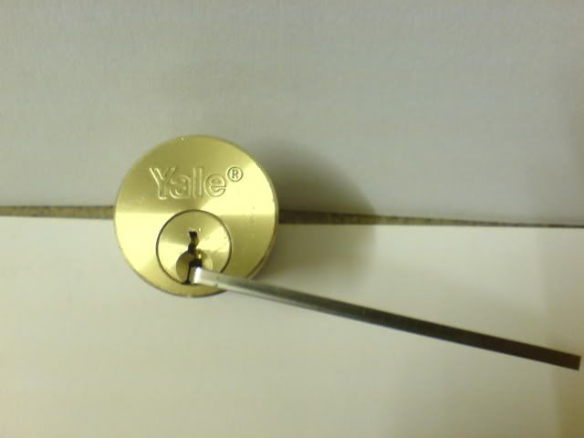

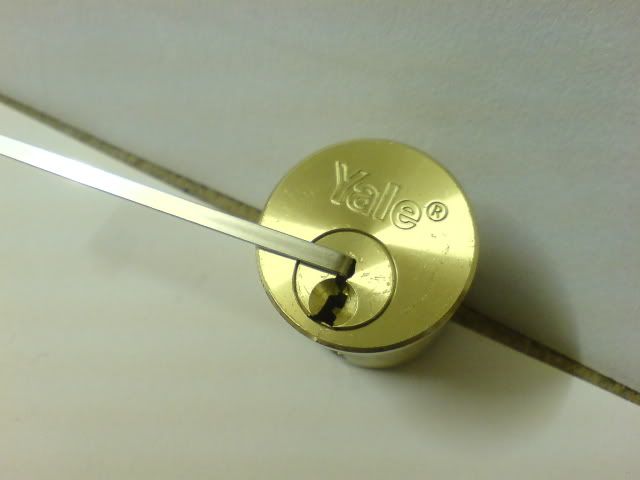

Postby Olson Burry » 1 Dec 2008 17:51
"Top" tension is excellent all round and especially in small keyways.
However you were not wrong using your original placement, I think the problem is simply that the wrench is too wide.
In the EU we would say you have the lock upside down - with the pins pointing up from the lower part of the lock so top tension in this case means simply in front of where the pins are.
A shortened wrench is useful in this case so you don't interfere with the first pin when you put it in.
Here are a couple more examples:
Top tension (anticlockwise)
Bottom Tension (clockwise)
All the best :)

Postby patrickson » 3 Dec 2008 8:43
thanks Olson!
Actually, since I first received good advices, I ve been experimenting
with both upper and lower tension and I think both can be used in different situations.
In Europe, most of our locks have their pins on the lower side,
so it s the opposite of what you have in America.
...that Yale looks so cool :D
