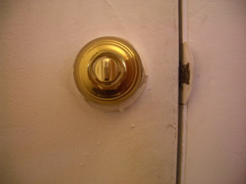

Hi there,
I searched around the FAQ section, but I feel like my case is a slight bit different. I am a college student living in an apartment. My room door has a lock, however, my roommate just showed me how he can break into it, and that worries me just a little bit. My real estate company just said that I am not allowed to change the locks inside the apartment because they need to be able to have full access to everything, blah blah blah.
I was thinking maybe getting one of those locks with the sliding lock. I know it's definitely not the strongest, but I just want something that will keep the door closed in case my roommate or someone else wants to break in while I'm here. I would love to change the lock altogether over winter break, however, the maintenance people would most likely notice, and I can't afford a fee like that ($200+).
Any ideas? Thanks!

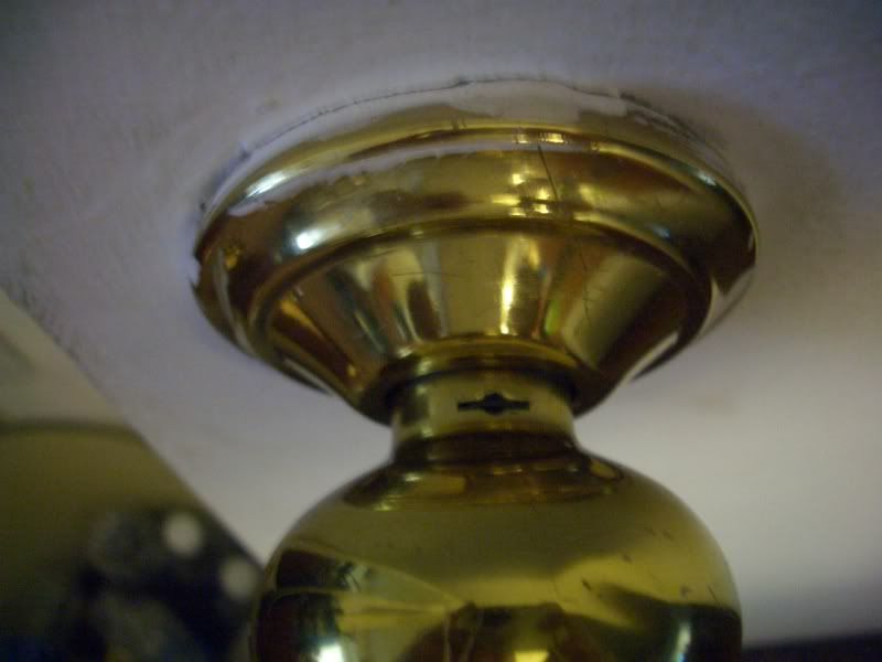

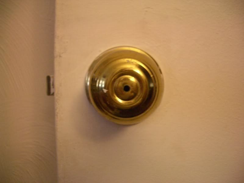

by lilfleck » 17 Dec 2008 14:03
Here are pictures of my current lock:    Pretty sure my roommate was able to get in with just a paper clip.

by lunchb0x » 17 Dec 2008 22:49
you don't pick it, you stick something in the hole on the outside knob to unlock it which is why your friend could get in with a paper clip

by raimundo » 18 Dec 2008 9:30
Bathroom door locks are made with small holes on the outside knob. This is so anyone who can push a small tool into the lock can get in. The concept is for seniors who may fall and be in distress, or children who are trying to get away from a maddened parent can be gotten to.
You have a bathroom door lock on your room. Go and look at the bathroom, if its lock is not the same, you could switch the two, since the landlord obviously hired cheap labor to install the locks and they didn't know what a bathroom door lock was.
