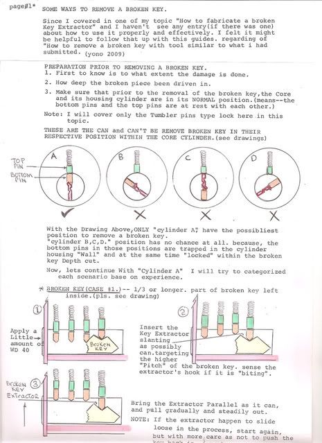

first page of :how to remove a broken key

Postby ToolyMcgee » 17 Feb 2009 6:44
Page 2: http://www.lockpicking101.com/viewtopic.php?f=4&t=43745
Very well organized processes. Great drawings too. I can't remember ever running into a key extractor post this informative.

Re: first page of :how to remove a broken key
Postby MacGnG1 » 17 Feb 2009 23:10
great instructions, i have a broken key extractor, and now i know how to use it
Postby globallockytoo » 18 Feb 2009 3:29
Only thing I see...is you suggest using WD40......that's a NO NO IMHO! :)
Postby mhole » 18 Feb 2009 5:50
Good info. IMO, the easiest way to remove broken keys, which is pretty foolproof, is to use your bypass method of choice to get access to the back of the door, and then push the key out from the back of the keyway.
As a lockie, I find that 9 out of 10 broken keys are the right key, in the right lock, snapped off no more than 1 cut from the bow and can be opened simply by turning the plug with small screwdriver. It takes a special genious to break off the tip of a key, halfway down the plug!
