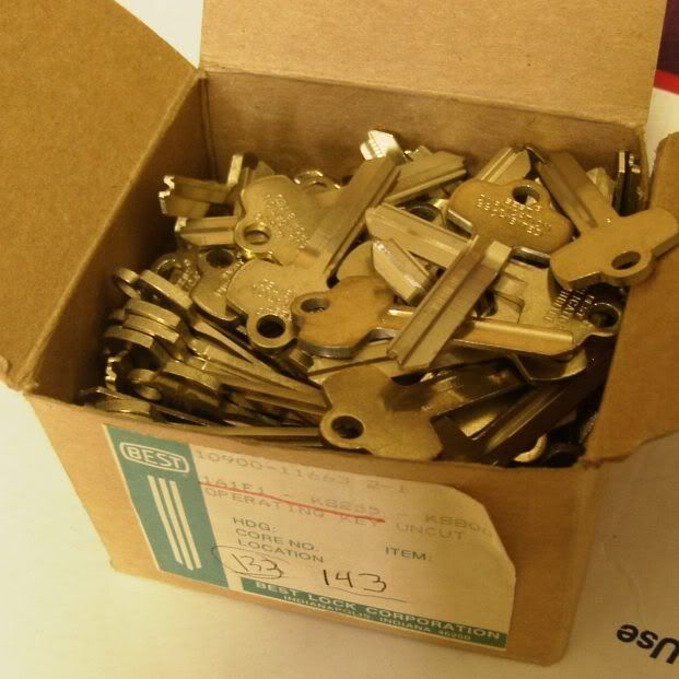

One + lots of patient + a lot of filing skills + a lot of these... then yes

Well you don't need a box of blanks, just six blanks (for a six pin lock).

Postby WOT » 23 Oct 2009 5:33
mcm151201 wrote:Well you don't need a box of blanks, just six blanks (for a six pin lock).
If you ASSume that;
1.) No more than two cuts per chamber. Not always true. Common area, like laundry room, restroom, etc would likely have stacks with multiple master pins. (i.e. 1,3,5,7,9). In the presence of multiple stacks with multiple master pins, the number of blanks needed is increased.
2.) The yield is perfect with zero miscuts. Good luck on that on a combination of using files and little experience.
3.) That in a RC system with more possible combinations than the key system can provide, there is no false master pins in constant position to discourage the discovery of the constant bitting in that particular chamber. (even if the institutional lockie might not be smart enough, the software he used maybe able to do this)
WOT
