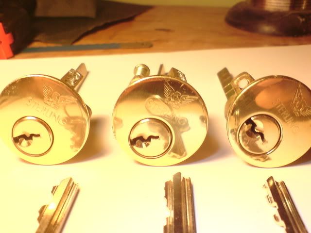

4) Padlocks can be tricky because of the smaller keyways a lot of them have, I think your best bet is a cheap standard 5 pin like one of these, doesn't have to be the same brand, just cheap will do usually.
They are pretty easy to take apart and the cheap ones wont have any security pins in. Yales do and they'll be more expensive.
Or ask family or friends if they've got any.. sometimes when people move and change the locks the old ones get kept in a draw or people lose the keys to padlocks, all good things to have.
