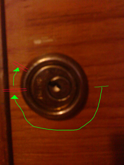

Well i got my kit today and decided to try on this little Phillips mounted 4 pin lock, its one of those rotating ones that you have to turn several times and you cant pull the key out unless you are finished spinning it.
So well i succeeded in picking it (single pick) but as soon as i turned it 180° it locked again and the pins wont move, and even keys that normally would normally fit, wont go in anymore, its in that current "locked" state that wouldnt let the original key to get out.
Is there something i can do about this or i will have to drill it?

Postby Baal » 6 Oct 2009 7:07
the pins are simply not moving, i cant push them back in.
Ill try to explain what kind of lock it is, you know those locks that need 360° or more to function that have no spring to return to normal position and wont let you pull the key before its fully open (or closed).
Its not a matter of force either because keys wont get in either, no matter how hard i push or giggle the cylinder.

Postby Baal » 6 Oct 2009 18:20
MacGyver101 wrote:
Baal wrote:the pins are simply not moving, i cant push them back in.
Urm, sorry... just to be 100% certain: which pins are you trying to move?
If the lock is stuck with the plug rotated 180°, then you should be looking for "pins" (the drivers, actually) pushing into where the bottom of the key would normally be... it's those pins that you should be lifting up. If you've tried to force a key in while it's in this position, though, you may have caused other problems, as Raymond suggested in this thread.
yup the same thing described in the thread happened to me.
The lock wasnt in normal position, it was sideways, the key pins were originally facing west and no they are facing east.
I am not sure i totally understood you, do you mean that cylinder has "holes" on the side the key is flat, so when it was rotated 180°, the driver pins fell on them locking it in place, and i have to push them back in and keep rotating?
I mean the driver pins are sticking out on the opposite side of the key pins?.
This makes sense because the tension wrench is not going in all the way as it did before

Postby Baal » 6 Oct 2009 18:26
oh yeah it looks like the drive pins are sticking out on the "wrong" side... so i have to push them back in with some torque like if i were lock picking right?
BTW why does it have those holes in there, is it to make it more secure or something?
Baal

Postby Baal » 6 Oct 2009 18:41
UPDATE:
Ok i understood what you meant, i pushed the drive pins back, the cylinder rotated another 25° and gets stuck again, i cant feel any drive pins sticking on the flat side of the key now... what now?

Postby LocksmithArmy » 6 Oct 2009 18:53
ok... now we need a picture... I have a few theories but a picture would be nice
Maby your cylinder housing has holes in the bottom off to the side for rekeying and the key pins fell into those holes... in that case try turning the whole locks so that the keyway is rightside up(the locks it upside down... sorta) and give it a good shake or a gentle rap while wiggleing the plug with your tensor... this should allow the key pins to fall back into the plug and allow you to rotate the cylinder the rest of the way... hopefully. I am assuming this lock is not attached to anything and you can flip it around any which way in your hands.
the reason the bottom of your plug is open is because that is where the key goes... why plugs arnt closed on the bottom I dont know, some are, in some the keyway is too small for the driver pins to fall in... others just have that fault... oh well be careful and its and easy fix, usually
LocksmithArmy

Postby FarmerFreak » 6 Oct 2009 19:12
Is it stuck turned that extra 25 degrees? Or can you turn it back to the original problem at 180 degrees?
It's possible that it's a cheap lock and when you picked it originally it had a shallow cut and the driver pin stayed with the key pin. If this happened (or if a driver pin got taken out when it was turned at a 180), you would have started to crank on a spring after "it" dropped into the keyway when the other driver pins did. And it wouldn't be so likely that you would have lifted it up enough to prevent it from being crushed and dragged between the cylinder and housing. This would likely cause the lock to completely seize at some random position. Sometimes you can fix this with a screwdriver and force. But using force is rarely the solution, and the lock may never be the same.
I'm not saying that this is what happened to your lock, it is only an idea.
Pictures would be best, but there may not be a good solution. Either way please take pictures before trying to force the lock.
And hopefully the lock isn't mounted to anything. This is a good example of why not to pick locks in use.

Postby Baal » 6 Oct 2009 19:17
Well the bad news is the lock is mounted, its from a little door i lost the key a while ago so i decided to try my lock on it, so i cant move it around.
i didnt understand what you were trying to say, could you maybe draw it or something?, im a newbie so its hard to picture some things.
