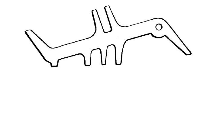

I found this diagram for a universal tension wrench I like, also with a brief description of how to make it. The only problem I have is resizing the picture in I have to the correct size so I can actually cut the steel to the correct shape. Anyone know any free picture editing software that will let you size an image down to real life measurements...? I don't know if I'm explaining this right or not, but I'll try to put a picture in this thread also.

It says to cut it from .035 stainless steel stock, and should measure aprox 3.5 inches long and 1.25 tall...
Could anyone tell me a way to resize this to make a template? thanks.

To save you some of the trouble, I've converted your graphic into a PDF file as best I could, using the scaling information you provided. (At exactly 3.5" long, however, the drawing is actually 1.5" tall?) Unfortunately, the forum software won't let me upload a PDF file directly, so I had to zip it first. :?
If you unzip the attached file, load the PDF into Adobe Acrobat Reader and then print it out you should have a properly-scaled copy. (Just be sure to set the "Page Scaling" option to "None" in the Print dialog before printing.)

MacGyver101 wrote:(At exactly 3.5" long, however, the drawing is actually 1.5" tall?)
Ah, okay. I had a second look at this, and figured out my misunderstanding.
The proper scale is not that the tool is 3.5" long... it's that the outline of the tool when rotated into that position should be 3.5" long (at which point it's almost exactly 1.25" tall). :oops: I've re-scaled the image and created a fixed PDF. If you print it as I described in the previous post (and assuming that you're trimming off the lines) you should have it at the right scale.

Postby CptedIV » 14 Oct 2009 11:27
Awesome, thanks a Mac I'll have the pictures up as soon as its finished.
I'm planning on using a cutting wheel to start, then a dremel and bench vise to finish. Should work, right?

Ha ha! did you ever eat with a "spork", that weird thing that is half spoon and half fork? If so, then your pictured cross between a dolphin and an anteater is about the same thing. Some people have way too much time on their hands to come up with stuff like this.
A good set of standard tension tools is all you need.

ElAbogado wrote:A good set of standard tension tools is all you need.
I think that's what this is aiming at. Instead of having one for tubular locks, one for dimple locks, one for double sided wafers etc etc.
This is meant to be the Swiss Army Knife equivalent.

Could somebody explain what each part does? I think the two pronged one is for tubular and the two ends are for normal pin tumbler but what are the three prongs for?
