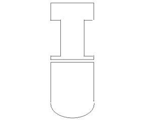

It should be set up like this.
With the small end towards the key pin. Locksmitharmy might be correct about it being difficult the other way. But that would only be true if it was over a shallow cut, since otherwise it would only act as a regular driver pin.
The simple way to test if it will have the desired spooled effect, is to have the keyed up plug in your hands (without a key in it). Then put the driver pin on top of the key pin and make sure that the spooled section is crossing the shear line at the resting position.

FF Thanks! even with a pic! Awesome! It's kinda what I'd expected, but lacking the experience with adding spools it seemed prudent to ask.
