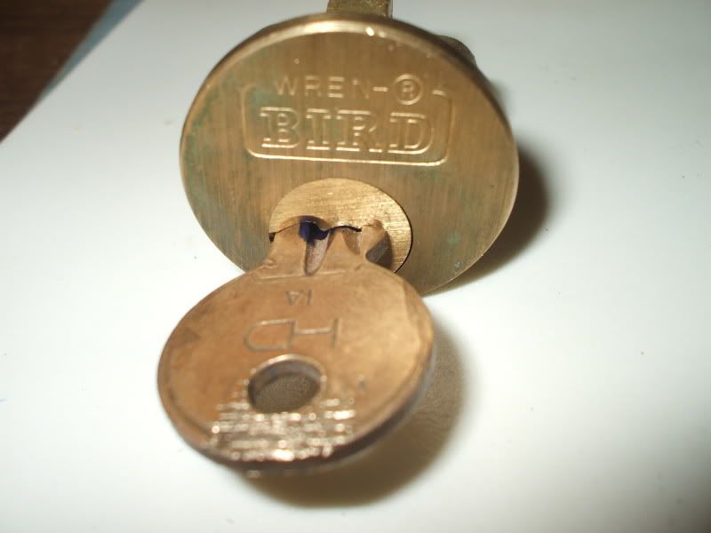

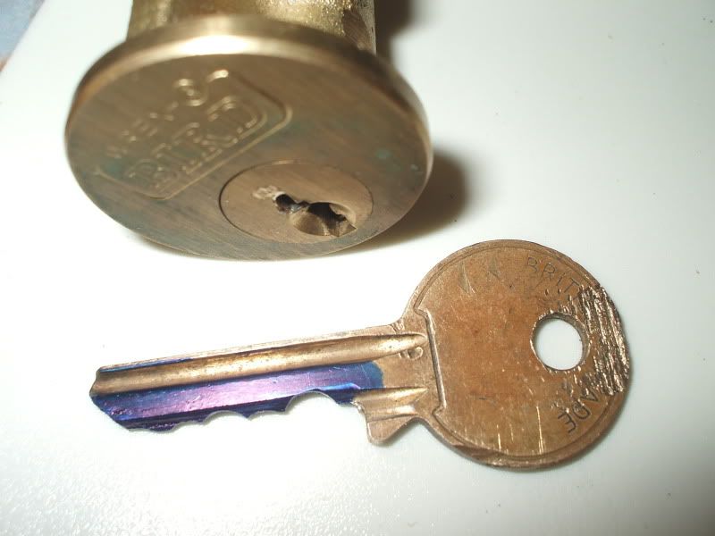

Postby femurat » 30 Nov 2009 6:39
Hi Rickthepick,
I'm playing with files too. If you haven't seen it here is my story.
This was a rainy weekend, so I'll post some more pictures soon...
I don't think you need a wafer lock. I suggest you to try again with your lock, but with just two pins. When you have a working key add the last three and continue your experience.
Re: help impressioning
Postby Rickthepick » 30 Nov 2009 7:58
iv actually accomplished it today with a relatively tame 5 pin Bird cylinder. I almost fell off my chair when the key finally turned haha 8) 40 mins later and a sore hand...
really chuffed.
it seems a bit rough and only seems to turn one way.
im assuming you take a little more out of each groove now to smooth it out and then copy onto a new key?
