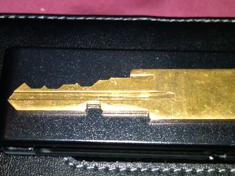

I have a question for everyone out there in the lockpicking101 world. I have a key that my grandfather gave me. Its a regular cylinder key, but it has a small notch cut out on the bottom of the key. I've never seen that on any kind of key before, and I'm very curious to know why and what that notch is for or what it means. Anyone who can help answer my question or tell me anything about the key would be much appreciated :D Thanks! I'm going to attempt to post a picture of it now.

twiggymm777 wrote:I have a question for everyone out there in the lockpicking101 world. I have a key that my grandfather gave me. Its a regular cylinder key, but it has a small notch cut out on the bottom of the key. I've never seen that on any kind of key before, and I'm very curious to know why and what that notch is for or what it means. Anyone who can help answer my question or tell me anything about the key would be much appreciated :D Thanks! I'm going to attempt to post a picture of it now.
That is a 6 pin Titan type control key for removing the cylinder from a Kwikset deadbolt lock without disassembly of the lock. The notch permits the retaining pin in the cylinder to drop releasing the cylinder when the key is turned to the correct position.

Postby lock2006 » 2 Dec 2009 16:49
That's right what ElAbogado said
This key is use to rekey or removing the cylinder from a Kwikset deadbolt lock
you are not going to see this key at home depot,unless you get it from a locksmith
or on ebay hope this helps.

I count 5 pin cuts :) just sayin'....

1 2 5 4 6 6 - six pins.

kwick set core change key..this key will remove cly from the lock set to rekey lock, with out take'n off the hardware

Thanks guys. Helps a ton. One more question.. I'm guessing the key cuts have to match the pins in the cylinder in order for it to work right? Like it can't really be used as a tool to take out cylinders for just any kwickset deadbolt

Postby FarmerFreak » 4 Dec 2009 12:05
Yes that's correct, the key has to be cut correctly for the lock. Otherwise it simply won't work.

Postby thelockpickkid » 4 Dec 2009 15:12
You can also make a copy of the regular key and put the cut on the backside of the blade in the same spot and it will also work, makes it to wear you don't have to buy these blanks

Postby UEDan » 4 Dec 2009 22:06
Or just make a bump key.

Postby raimundo » 5 Dec 2009 10:15
you can also copy the key you have and keep the control key back from any use you have for it so when your neighbor borrows the key no slipups happen.
looks like the individual key can just be slotted to make this control key and it probably doesnt matter how carefully you shape the cut as long as its big enough to pass a ward is my guess.

Postby mh » 5 Dec 2009 17:45
Does that mean that when there is no key in the cylinder while it is turned (read: when picked),
the cylinder will come out of the housing?

Postby mcm757207 » 5 Dec 2009 18:05
mh wrote:Does that mean that when there is no key in the cylinder while it is turned (read: when picked),
Cheers
mh
You got it.
