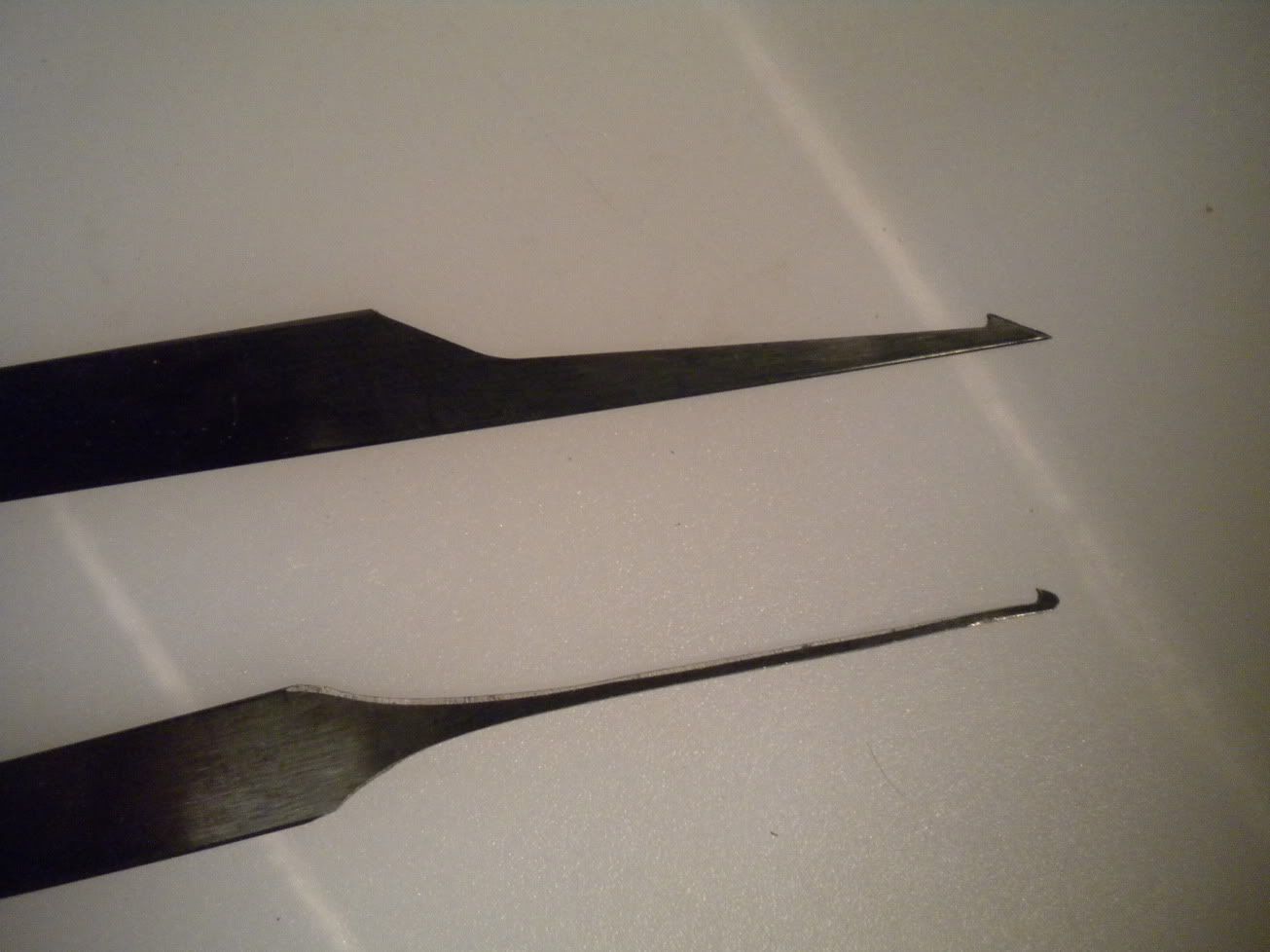

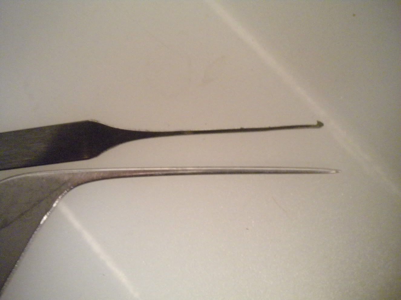

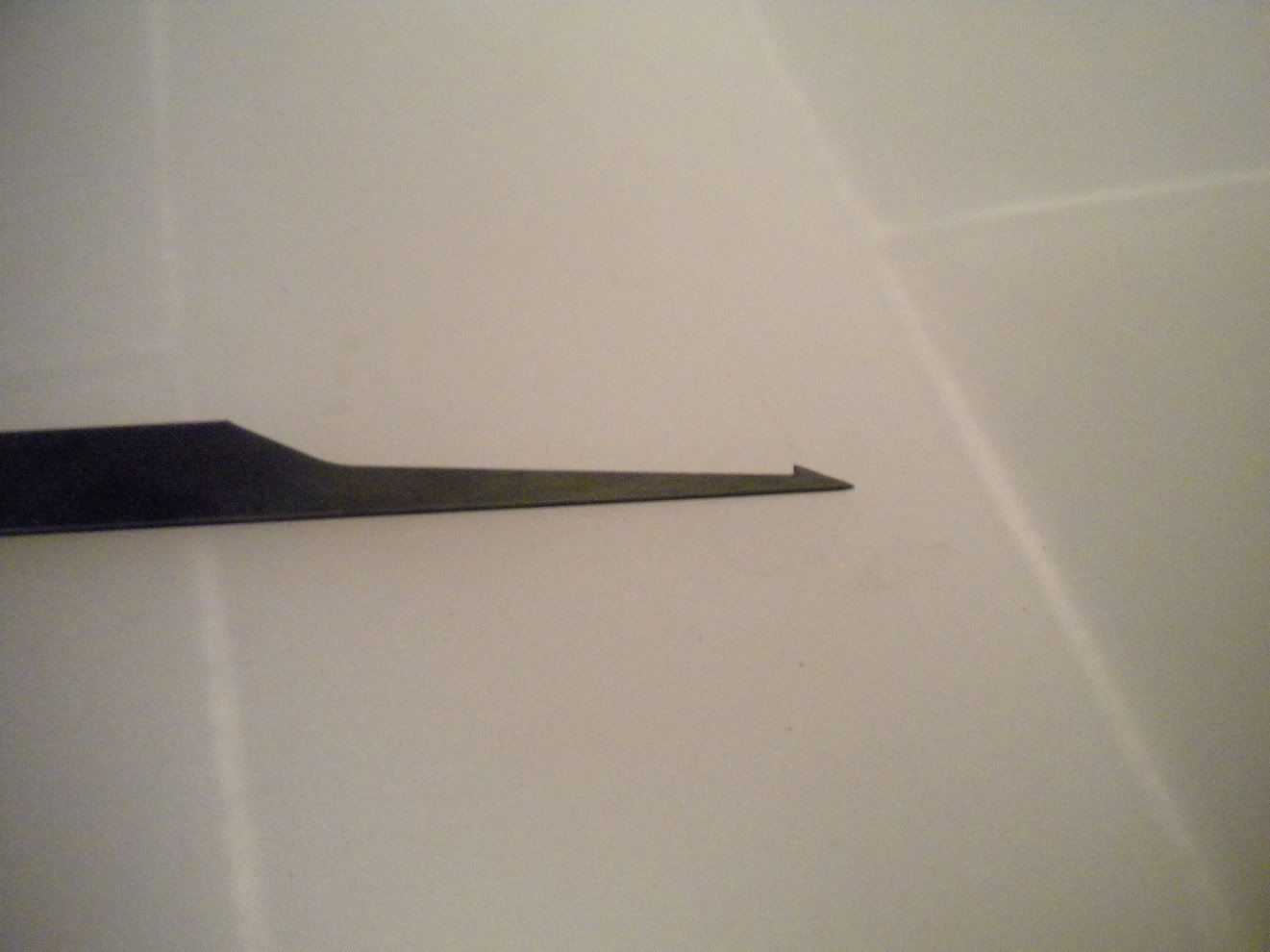

What I recommend isn't spirals, I'm not a fan of them. I prefer a small hook that goes behind the key and pulls it out from the tip. Most of the ones that are sold and claim to be good,...stink, they are too thin and break far to easily.
Get yourself a couple of HPC EZ-2 key extractors. Without modification they won't be of any use, but they are cheap to buy.
This is how they come, big bulky and crappy. Then you grind it down to the size you want.
This will be stronger than the thin ones sold this way. And thus it will last longer and pull out many more keys before needing to be replaced.
The next problem is pushing the wafers/pins, or whatever else may be in front of the broken key out of the way. To do this I use what I refer to as a "sight tool" They aren't sold anywhere. It has to be strong, straight, come to a point, and be offset so you can see into the lock while holding it.

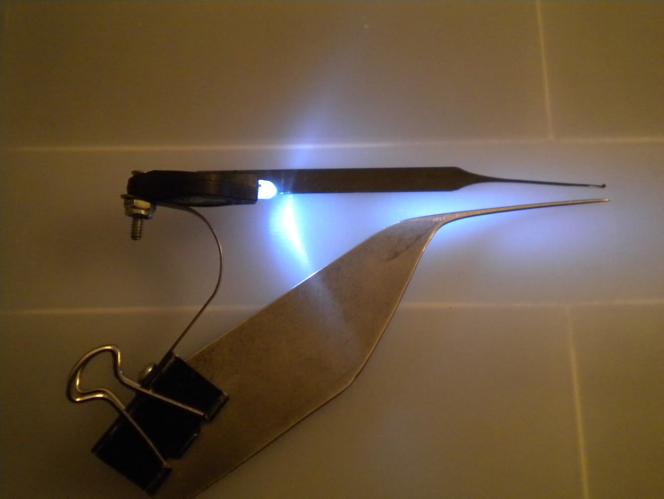

Now you just need to light up the keyway, so you can see what you are doing.
Since you only have two hands, sometimes I find it helpful to clip the light to the sight tool.
Look for some HPC EZ-2's and have some fun. :)
