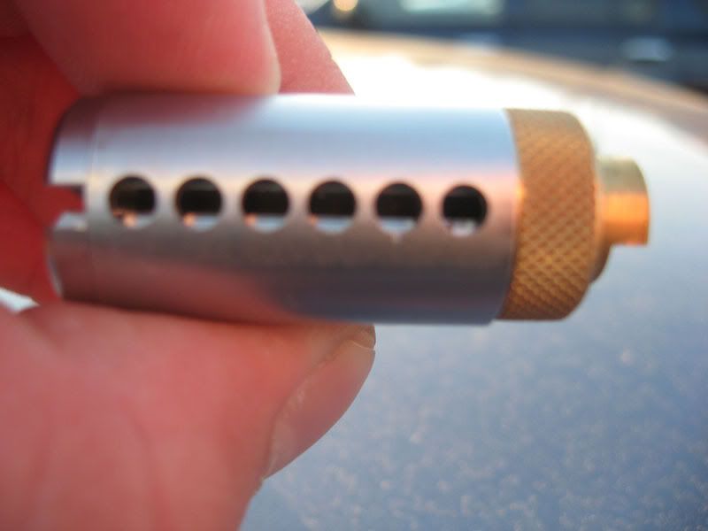

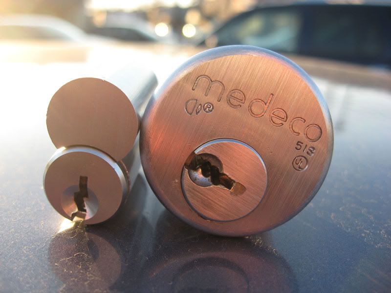

Postby Josh K » 10 Mar 2010 17:15
Here's pictures of this Schlage, I'm getting the key back tomorrow. Left it with a friend by accident.

Postby Klaiviel » 10 Mar 2010 23:37
I guarantee you can get that Schlage open tonight. All Schlage's pick extremely easy backwards; couple that with TShock's 2min or less plug spinner viewtopic.php?f=4&t=9096 and your good to go. I attached my mousetrap spring to a drilled wooden dowel for an ergonomic handle; however in a pinch a locking pliers will work too. Good luck!
P.S. - I can pick my Schlage in the correct direction as well; however, it is simply not worth it when the right direction takes me 8 minutes vs the wrong direction + plug spinner takes me 20 seconds.
P.P.S. - When picking backwards your tension wrench actually nicely fills in the nasty gaps in the Schlage keyway, I actually lever my short pick off of it and it works quite well. Here is a horrible picture taken from my phone to give you and idea of what I am talking about.
