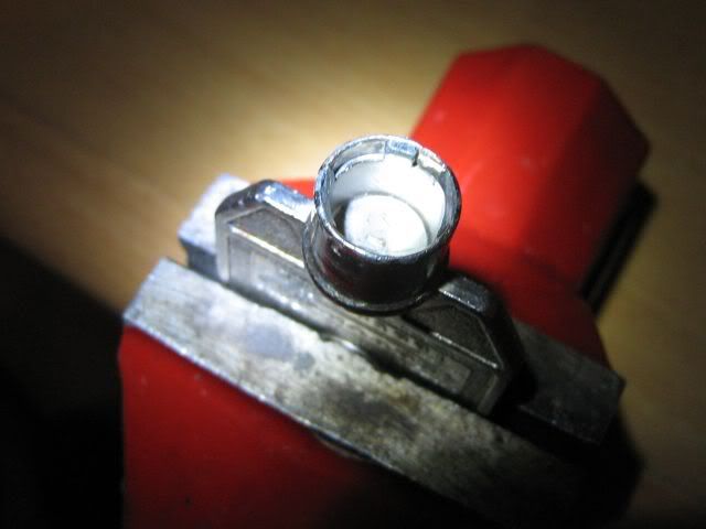

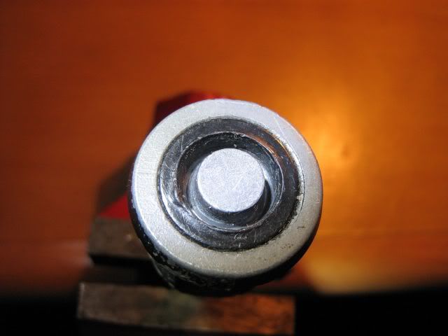

I'm confused by a Southco cam lock that closes the gas bottle compartment on a caravan I just bought. There are two locks for a 5ft fibreglass door. It's a cylinder key marked 715 which seems to be a standard. The locks are marked Southco too but no part number. The key fits the lock but doesn't turn the cam as it has nothing to grip on to. There are grooves in the key but none on the lock. It's not that they have worn off: they were never there: there are no scratches in the oxidation layer. I thought perhaps the trick was to push down the outer cylinder thus exposing the keyway but the outer facing metal is a smooth 'top hat' of die cast alu or zinc.
There is some complex locking mechanism inside and it's not broken as both operate the same. The top hat moves inwards about 2mm under pressure and the rear threaded shaft is also sprung loaded outwards. The shaft turns through 90 degrees with the top hat when out but when pushed into the lock (moves about 6mm) turning is resisted (ie: 'locked'). Push in and turn fractionally and it pops out 3mm but is still locked. Push the top hat in from the front and release, and so does the shaft which will now turn again.
It's marked Pat pend. and I had a look at some Southco patents but there are too many and I didn't find the one for this lock.
It's possible that the 715 key, although fitting, doesn't match the locks. But I can't see how the lock was ever supposed to work as no keyway is visible.
The lock is assembled from the outside and there's one 1x4mm rectangular push pin from one side holding it together. So no easy disassembly. I took pics but as a newbie I can't post.
Can anyone tell me how a lock with no keyway works??

That particular type lock is called a vise action compression lock. They are used on tool boxes/doors on railroad equipment, trucks, etc. to keep the doors from opening due to vibration. They work exactly as you indicated - the rubber gasketing is compressed by pushing the door closed and throwing the latch and are operated by a "tool" that matches the lock. In your case it appears that at one time it had raised portions on the inner part of the lock where you insert the key that match the key. Yours appears to have worn off from usage. Time for a new one!
straightpick
Posts: 221
Joined: 14 Aug 2008 22:41
Location: Pennsylvania, USA
Re: Southco locker lock looks like it can never work!?
Postby Mike633 » 22 Sep 2010 6:07
I was going to disagree, but a bit of work with a drill and you are right :)
What confused me was the Southco brochure I looked at was smaller vice latches so the dimensions were wrong, plus the locking mechanism I could engage which I did not think was needed for the 'faux' latch, plus the relatively unmarked top hat on both latches, plus the spring bias outward when I thought a latch would be inward
So for the record, I find larger latches here
http://www.southco.com/list/e3-vise-act ... 76.000;783
The top hat sides are oxidised so look unworn. Clearly the newly exposed metal is shiny where I have cut a screwdriver slot:
I can only imagine that the teeth were worn off many years ago.

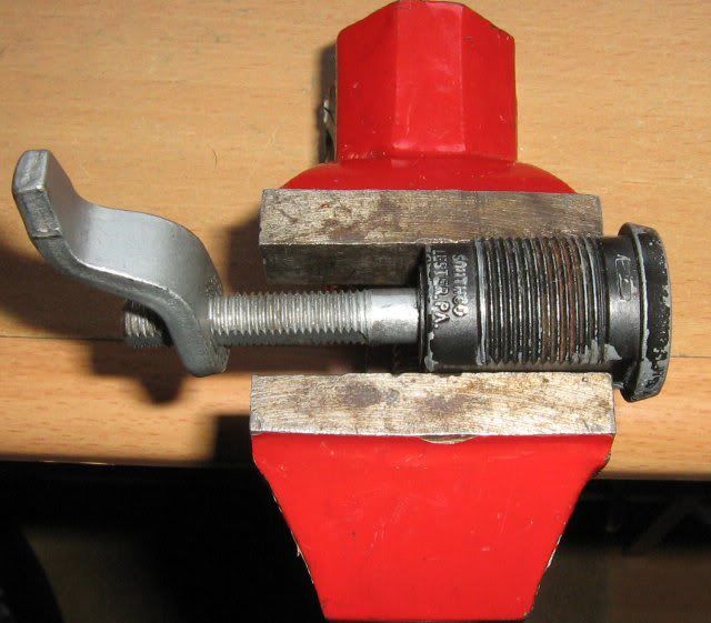

On the locking mechanism, this is open:
The first quarter turn acts like a passive latch:

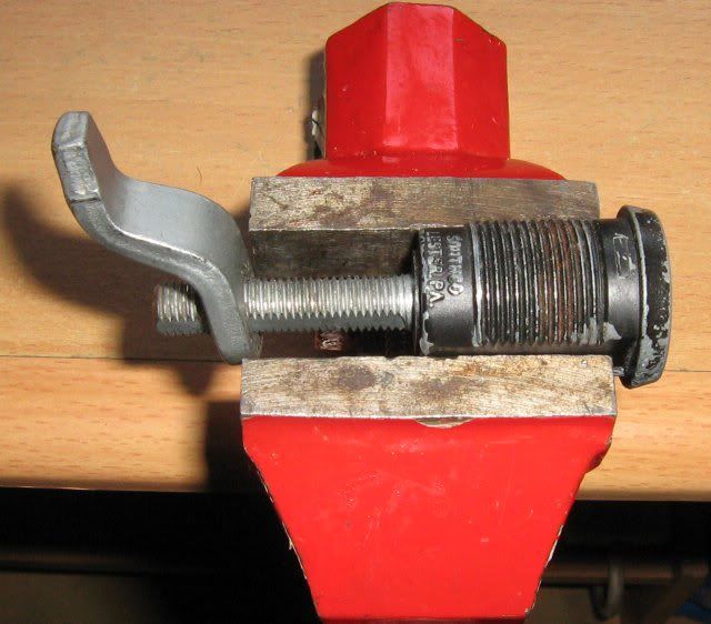

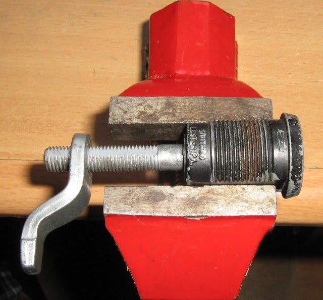

During the second quarter turn of the key, the lever stays at the same angle but is pulled into the lock body by 6mm. Compare the unthreaded section of shaft:
In this position it is 'locked' in that the lever cannot be turned, it has to be released by the key.
