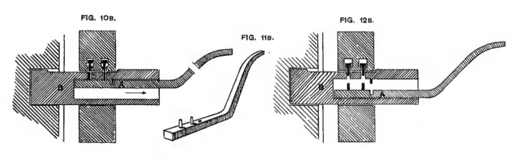

My best guess, based on the shape of the key, is that it was used in a very old-style pin-tumbler sliding bolt, similar to the ancient Egyptian locks.
The only good reference I have to medieval versions of those is from an 1883 edition of Development and Distribution of Primitive Locks and Keys (by Pitt-Rivers); here's a sample illustration from from that text:
Basically, the key was inserted and lifted: the fingers of the key pushed the pins up to the "shear line", which then allowed the bolt to slide.
Can't guarantee that's what your key was from, but it's a pretty good bet.

MacGyver101 wrote:My best guess, based on the shape of the key, is that it was used in a very old-style pin-tumbler sliding bolt, similar to the ancient Egyptian locks.
Sounds like this is probably correct, thanks for the answer!

That thing could be roman, the egyptians dont seem to have left any iron examples, only wooden ones.
In its day that was a highsecurity lock but apparently it didn't need to have variations in the depths of the lifters

raimundo wrote:That thing could be roman, the egyptians dont seem to have left any iron examples, only wooden ones.
Sorry: I hadn't meant to suggest that it was actually from an ancient Egyptian lock.
The diagram I posted was of a more "modern" version (circa 16th- or 17th-century). My guess was based on both the position of the pins (and, as you correctly note, the uniform height), and also the orientation of the key bow -- which looks like it's positioned to help with a lifting motion. (For keys that are meant to twist, the bow is normally attached the other way, to make the key flatter and more convenient to carry.)

It looks like there may have been a seventh pin there on the bend it may have been straight to start out with, could it have been for a warded lock on the inside of a door this would account for the length.
