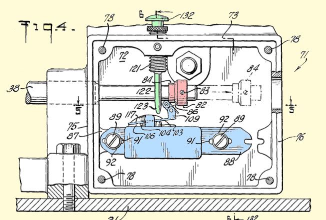

Ah, okay... mystery solved. :) Here's the patent: US Patent 3,196,750.
There used to be a power switch inside that cavity that controlled the motor (coloured blue in the figure below):
The switch was a simple "push on, push off" style of switch. Depressing the button (coloured green) would toggle the switch and turn on the motor. When the key cutting was finished and the key carrier reached the end of its run, the collar on the end of the rod (coloured red) would toggle the switch a second time, turning off the motor.
So, it seems you have everything there except for the switch.

wow thanks! i searched for at least an hour on google and couldn't find those diagrams! i guess it makes sense now, the machine is now on a manual switch and just keeps cycling over and over when on. i guess im on the hunt now for that switch. Anyone know the specific name for it, i found out its a Micro switch but the one on the diagram seems to have dual rollers and i haven't seen those on google searches or ebay.

i believe that my machine of a similar age has a replacement microswitch, and it's not a roller switch at all. (slightly different layout, forgetting the model # off the top of my head)
for casual use i suspect you'll be fine with any microswitch that you can get in about the right spot. look into a place liek ax-man surplus for odd switches. if you're set on a double roller, i can ask some of the electronics geeks at the shops for a recommended supplier.
