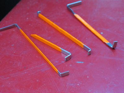

Postby atticRR » 13 Jul 2012 22:21
heres a pic of my tensioners The center one looks the same on both ends and is made from a wiper insert. Both sides are super short for TOK tension in brass padlocks. You can see one of the nothches from the wire cutters, its on the thin upper edge with a matching one opposite that you cant see.
The wrench to the right is one i got with the picks i ordered, the end in the photo i custom made for top tension for master locks-its long enough to get around the rivets and into the recessed keyway. The other end is standard bottom tension-in other words, long.
The one on the laeft is showing the stock end, the other end has a custom, shorter, bend on it. Really, i promise, i just suck at photo composition.
Hope this helps you out.

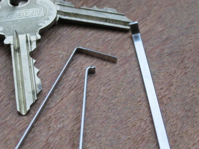

Postby atticRR » 16 Jul 2012 14:37
heres another pic you see the 'teeth' i cut into my wrenches. The new color is there because i'm tired of having to locate them when they go flying into the grass between the stones in my patio while picking.
