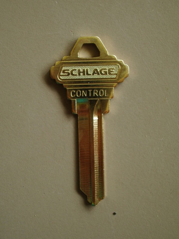

That's a Large Format Interchangeable Core from Schlage, there is a special control key that would be inserted in order to retract a pin, sticking out of the core, which makes it stay in the shell.
Here's a post about doing so:
http://www.lockpicking101.com/viewtopic.php?f=9&t=49081
The special extra long control key blank $2.00
http://americankeysupply.com/index.php?main_page=product_info&products_id=1744
Or you can just pick the lock and then go deeper and retract the control pin using a pick. Some pins are on the left, some on the right, so you will have to figure out which direction to pick the lock in your case. I've been consulting with some other folks (averagejoe and keysman) and they should be here in a minute to offer wisdom on this.

As Squelchtone said, the control lug/pin is controlled by a longer key. A key cut to any biting that will open the lock on a control blank will be a control key.

In the first picture, the silver part near the rear is the control lug. It is separate from the normal plug so it cannot be tensioned. Having never picked one of these before I cannot offer a surefire way of picking which end first but I do know that the pin needs to be held up at all times. If you pick it to control and let the last pin down the control lug will snap back.
Perhaps you could cut the tip of a normal key to a 6 depth (what I have heard it is) and then grind down the rest of the key so you can put it in and take it out while leaving enough room for a pick. You would also have to cut the shoulder back, just count until it is under the 7th pin stack and you should be golden.

Your last tip will work. You can cut a 6 pin blank back slightly in order to make an emergency control key. The tip will look like this.
http://i.ebayimg.com/t/Schlage-Control- ... -w~~_3.JPG

I just had another thought... If I impression a working key and then file down the shoulder on a blank to fit a seventh pin and cut the last depth to a six, then copy that new blank with the impessioned key from the shoulder, that should create a working control key should it not??? Just wondering...

Just order a couple control key blanks. Impression a working key on a 6 pin blank and then copy that key on to a control blank. The last depth is precut on those so you only have to worry about the first 6 pins.
And by ordering a couple extra blanks you can make a new control key when you get it pinned to your system.
