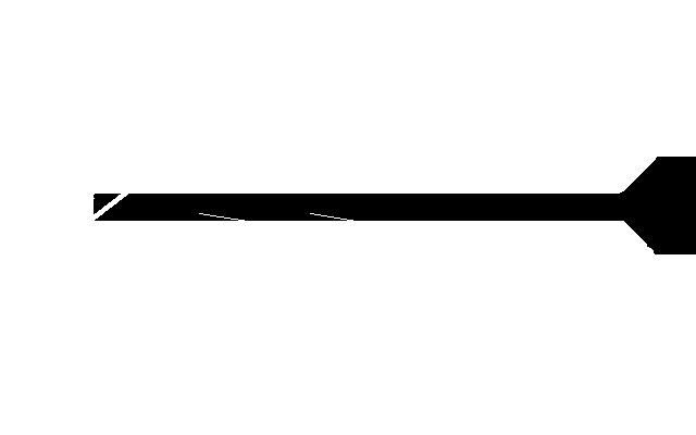

They're removable with a very easy to make tool.
The procedure is basically just a broken key extraction, but you have to hold up the pins while you do it too.
You start with a Weiser shim, or a similar piece of metal.
It's .008" thick, spring steel.
You modify it by making cuts as shown in this diagram.
The two thin cuts along the side should leave you with a couple of very sharp barbs.
Bend those slightly so the points lean towards the key as you slide it in alongside it.
The angled cut on the tip helps lift the pins out of the way as you insert it.
By cutting off the tip, when you insert it alongside the "Kill-Key" you can raise up the lock pins.
Once the shim is fully inserted alongside the key, the barbs should bite into the side of the key, keep the shim at the top of the keyway to hold up the pins, and gently remove the tool.
If the barbs have sufficiently dug in, it should slide the broken key out with it.
If needed, use other key extractor tools to assist the removal, but maintain upward pressure with the shim to keep the pins lifted.

i_b_larry, the tool I posted above will defeat it, at least with most residential locks found in the US. The keyways are almost always loose enough and straight enough at the top to allow the shim to be inserted alongside the key.
As I described, the shim lifts the pins so they are no longer trapped by the vertical cut on the key.
