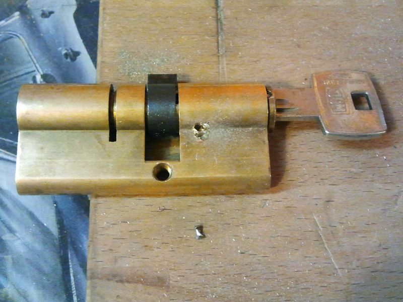

Postby femurat » 21 Jan 2013 10:35
Something similar happened to me while reassembling a DOM I disassembled and cleaned: the small pin that interacts with the ball in the key fell into an empty side-pin hole. I've tried all the suggestions above, but unfortunately nothing worked. I had to drill the side of the lock to remove the stuck pin :-(
You can see it on the table below the lock, I drilled just below it and pulled it out slightly damaged. Now at least I have some spare pins and spring that I can use to rekey differently the other side.
