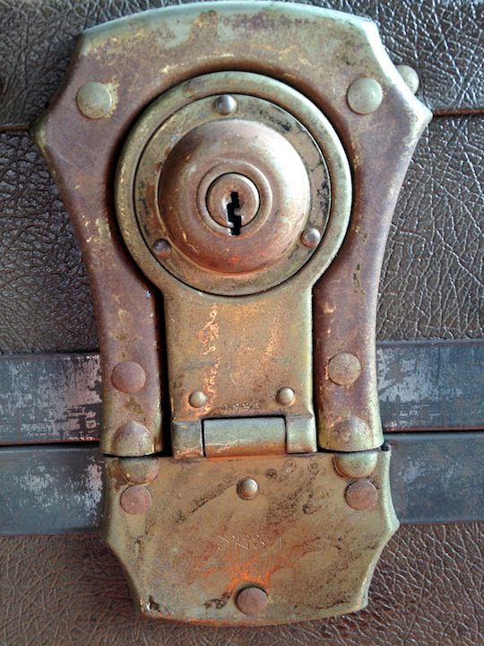

I am a COMPLETE beginner to the art and science of lock-picking, other than using a flashlight trick to get into her luggage. My only tools are paperclips, bobby pins, fruit knives and whatever else might be found laying about the house. I did do a search on other steamer trunk threads here, but all the other locks I saw seemed to be straight vertical slots and none of the various tricks (i.e. scissors) seem to work. I realize it's probably impossible to give me a semester's worth of tutorial in 15 minutes, but I was more hoping someone might have a familiarity with this type of lock and be able to suggest a quick way of opening it without destroying the chest; as I said, it's something she's had since I was born and holds a rather fond place in my memory. My cartoonish fumblings with the above mentioned items have proved ineffective.

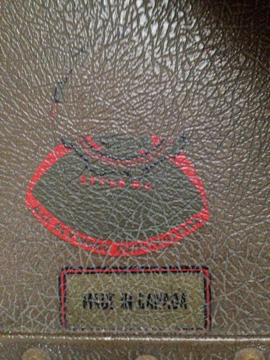

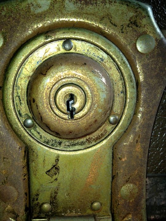

Here are some pictures of the lock and a very faded brand label for the trunk. Hopefully I'll stumble across the key this weekend and this whole discussion will be moot.

I don't know about that specific lock. Maybe the best would be to call a locksmith and have him open the lock without damaging it.
It looks like the usual steamer truck lock but with a diferent keyway. We call that a warded lock. Try to bend a bobby pin in an L shape and use it as a key at several dephts in the keyway.
Without looking at the actual lock it's difficult. Maybe one of the other guys has some info on it.
But, as I said, a local locksmith can open it without damaging the lock. And won't get expensive.
Hope it all turns in your favour!

That looks like a nice old trunk .. it actually may have some value as an antique. The lower picture shows a key broken in the lock .. perhaps that is the correct key?
As stated above, take the trunk to a locksmith SHOP …. not just some flyby night locksmith with a yellow page ad. They should be able to get you open and on your way for a reasonable cost.
You can look at this page to get an idea of what the key should look like .. should you come across it in you search.
It says long lock # 1932 on the hasp .. that is probably a code of some sort
luggage keys
or here: http://www.islandtrunkshop.com/antique_ ... _keys.html

Interesting that you say the key appears to be broken off in the lock. I thought that was just part of the tumbler mechanism. The angle might be deceptive, it's not blocking the key hole at all, I'm able to insert pins and clips all the way into the keyhole.
If it's any other help, the keyhole spins about almost too freely when I put something in to turn it about.
I've been trying the bent-into-an-L-shape pin trick and it hasn't really caught anything.
What's really funny is I seem to recall picking this lock when I was 9-years old... guess I peaked as a lock-picker 30 years ago ;)

Yes, it isn't a broken key. These usually use pre-cut keys with occasionally a few variations. However a locksmith in Thailand probably won't have the pre-cut key. They are however simple and a set of picks for warded padlocks will usually open these as well.

Thanks everyone for your insight and advice. I actually managed to find the key in the back of a closet - about 3/4" long and snub-nosed, with the same number stamped into it as on the lock. Sadly, while the contents of the trunk held a tremendous amount of sentimental value for me, none of the documentation or jewelry we suspected might be in there was to be found.
