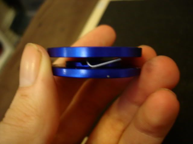

Just FYI, here's a pic of a curtain pick wire. The curve allows it to reach over the curtain and under the levers like so. Not as complicated as you might think!

Cool pics! Looks like there's no tab on the curtain, so it'll be the tip of the key which actuates the bolt.
For your tension wire, just bend an upstand the same height as the tip of the key (so it's the legth from where it rests in the curtain to the notch in the bolt). Same idea as the front tension method I explained in my guide, but instead of resting on the bottom of the keyway, it's the bottom of the curtain. As for the pick wire, a simple kink to alow it over the curtain and under the levers will suffice.
The levers look like they sit very low on the curtain so you'll probably need to corskcrew under them, which takes a bit of getting the feel for. It might be wise to make a prelifter, ie. grind a key down for tension so it raises the levers to their lowest cut height. This will apply tension and raise the levers a small amount, which will give you space to get under them with your wire. Any levers with a very low lift will be automatically set as well.
The good news is, the gates are considerably bigger than the stump and there are no false gates so they should be pretty easy to pick once you get the general feel for them. There should be a nice snap as each lever sets, and any set lever will have quite a bit of wiggle so it should be really easy to tell if a lever is set or not. Keep us posted!
