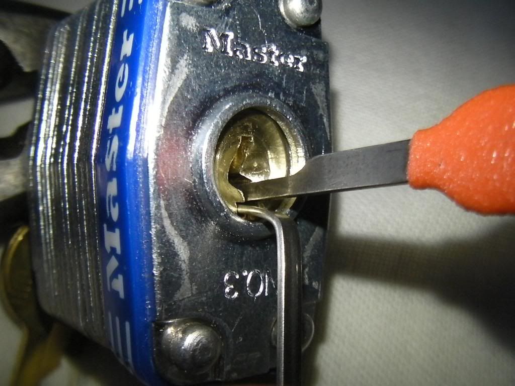

Here's a picture of TOK tension. You put the wrench right in front of--but not touching--the first pin. In the picture I bent a piece of wiper insert (courtesy of Gordon) as close to flush with the outermost protrusion of the lock as possible. This helps to minimize the tension wrench from flying out of the lock. The two disadvantages with TOK tension for me are that: you can't see the first pin, like you can with BOK (kind of a trivial complaint); and it can be harder to keep the wrench in than with BOK tension.

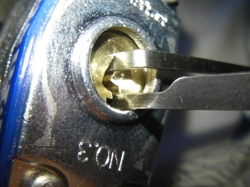

Here's a picture of the other end of the same wiper insert bent to go into the bottom-of-the-keyway. Note that there is actually more room for the pick with TOK than with BOK. As Superpicking points out, a lot of pickers overlift when trying to clear their tension wrench. To be fair, I found a perfect diametered insert that fit just as good-to-snug at the bottom-of-the-keyway as it did at the top to try to find a tension wrench that crowded the plug the least amount. Though taking up the keyway is one disadvantage, I find another disadvantage in how the tension is spread throughout the lock.
Also, from what it says in SuperPicking, BOK tension applies tension on the pins starting at the bottom of the keyway on the side the tension wrench is inserted, traveling diagonally to the top of the keyway on the other side of the plug. If a lock had it's front pins (1,2) theoretically bind first when turning CW with BOK tension, this would make it tough to bind a pin but not hard if a back pin theoretically binds first CCW on that same lock (with each pin being picked reducing the hardness of the lock being picked). I am, of course, not even factoring in the spool pins you were referring to in the lock you are working with, for simplicities sake. I may be wrong, I frequently am, but this is my understanding of the facts as I've found them presented to me. I've made the source for my opinion known as well. My purpose in this is not to persuade but to inform, I welcome any constructive criticism if I am wrong here :D ! Best of luck tomo18!
