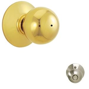

Sounds like Schlage F series....I hate them :evil:

Oh lord no. I hate this lock! It's been such a pain in the ass to open! :oops:
I don't even know ow to open it! It's only a freegin hole. :evil:

Agreed, that floating bible cap is a nightmare. If i had to open one I'd be inclined to just push the pins up so far that the bible cap would break off and then Just replace the cap or if possible switch it out for a solid brass KIK cylinder.

That lock is a privacy lock, intended for bathrooms and other interior doors.
Put a straight stiff wire into the hole, and keeping it straight, push it in until you feel it stop. Then push a bit harder, and you will feel it is a spring-loaded plunger your press. While it is pressed, then you can turn the handle.
Some of them will have a slot instead of the spring loaded plunger way inside. Then you use a very thin flat screwdriver to find the slot, and turn it 90 degrees. Those privacy locks can be determined by the knob that turns to lock the interior door, instead of a button pushed in.

Stiff paper clips usually work well. TO answer the OPs question, I don't know of any special tool to crimp the caps. I have just been using pliers.

Yeah, in a pinch taking a disposable ball-point pen apart yields a tube of perfect diameter to go in that "freegin hole" :mrgreen: .
