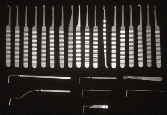

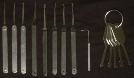

Thanks for your additional advice here, FarmerFreak. To be honest, I'm still struggling quite a bit with this lock. I thought I was able to set one of the pins, but now I'm not so sure. I think it might be a "false set," but I'm not sure because when I think I've set one of the pins the cylinder hasn't rotated at all, so that makes me think it might be a false set. I wanted a more challenging lock because I was tired of buying locks I could pick within minutes of my first attempt to pick it, but perhaps I've bitten off more than can chew here. Or, perhaps I do not have the proper tools to deal with serrated pins? I know people have their own personal preferences to pick a lock, but I also know some tools are more appropriate than others for the job.
Here's what I have and perhaps you folks can give me some suggestions for the best pick(s) to defeat this lock:
So far what I've tried using are the two hooks on the far left of the top pic and my half diamond along with a tensor I modified for TOK. I've been avoiding using any of the rakes I have because I'm afraid raking may ruin the lock (I've ruined some of my other locks with security pins trying rake them) and for obvious reasons I'm not using my picks for warded locks. I've seen vids of guys using a deforest hook to deal with serrated pins, but as you can see I don't have one of those right now. Based on what you see here, do you guys think there's a better choice of pick(s) for this lock than what I've been using? Thanks.

No. You're fine. Those are the picks I use the most. Most of the picks in my collection are just gathering dust. The ones that you highlighted in your imagery are the small collection most of us in the lock-picking community use as our go to tools.
Personally. I use the diamond as my lifter pick. Lifter pick you say? I use that term in the sense of lifting the key pins up one by one without tilting it against the key hole. SPP basically
The hooks, like the ones you are displaying, (short and medium hook) I use for small keyholes and large ones alike applying pressure as I tilt it against the keyhole.
