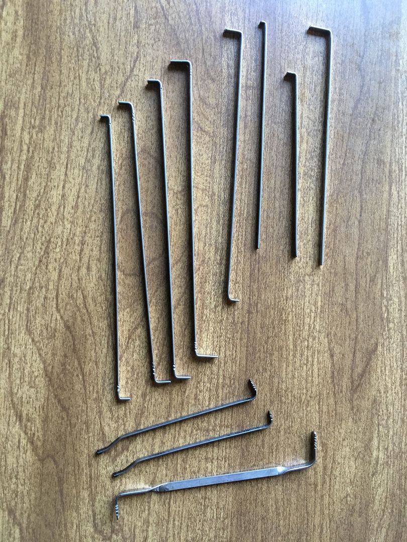

I have quite a few tension wrenches that I made from wiper inserts that are short enough to be used TOK, just like Squelchtone suggested. Just grabbed some from my primary kit and snapped some pics for you.
The little notches on the ends of the smallest tensioners on the bottom of the picture are to help grip the sides of the keyway to reduce slippage. The little notches before the end bends on the ones on the upper row left side are so I can quickly identify which ones are longer and which are shorter. That also allows me to grab a tensioner that does not reach too deep in the keyway binding the first pin stack.
Seen from the side, you can see that they are in varying widths of wiper inserts.
