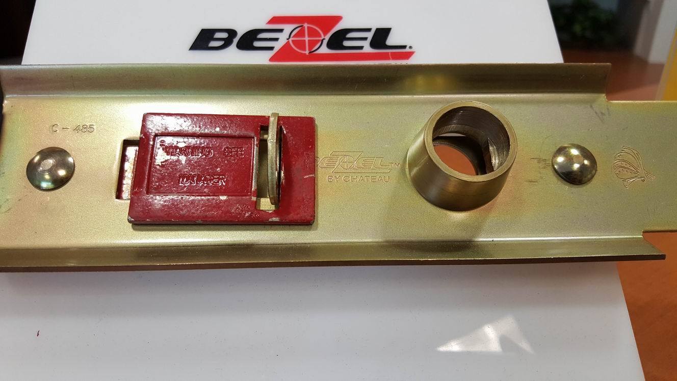

Another question relates to an offer that the manager made us when we asked her about using a second lock on our unit's door, given that the cylinder lock doesn't offer much security. She said that, as a rule, customers are not allowed to use a second lock, a padlock. These are used by the facility for units whose contents are going to be auctioned. Given the circumstances, however, she said that she would allow us to use a padlock, in addition to a new cylinder lock. In order for the padlock to serve its purpose, we would have to have a lock plate, like the red one uploaded here: http://a2zwriting.com/images/red_lock_plate.jpg
The manager said that we could find such a plate at our local Home Depot. But the expert at Home Depot said they did not have such an item in their inventory. Trips to two other major hardware stores, OSH and Lowe's, had the same result. And we have been unable to find the item online.
Does anyone know the correct technical term for this plate and where we might purchase one?

Here is the Chateau catalog, please enable Flash Player in your browser, look at top of page 87, that's the overlock plate you need, no way in hell would Home Depot have that, your storage employee is pulling your leg, they should just give you an over lock plate, they have them.
http://www.chateauproducts.com/html/2018-72-flip.html
call Chateau and order direct from them or see the link below:
$0.97 each
https://www.supplyside.com/item.aspx?catid=281

To contribute to the forum, I would like to include the answer I found to my question about what I now know is called an "over lock plate" (also known as a "lock-out plate"). The red plate shown in the photo to which I linked is a Chateau C-489. It cannot be purchased by consumers from Chateau, which will only sell to owners and management of self-storage facilities because they don't want ordinary consumers to have such plates. They restrict those plates to use for lock-out units. There is a record of occasional availability on eBay but only twice, as far as I was able to determine. Management at A-1, however, has agreed to issue us an over lock plate, so we can put a second lock on our unit, for some added peace of mind. There is nothing of great material value being stored there: mostly just books and papers. No electronics, no jewelry or anything like that.
