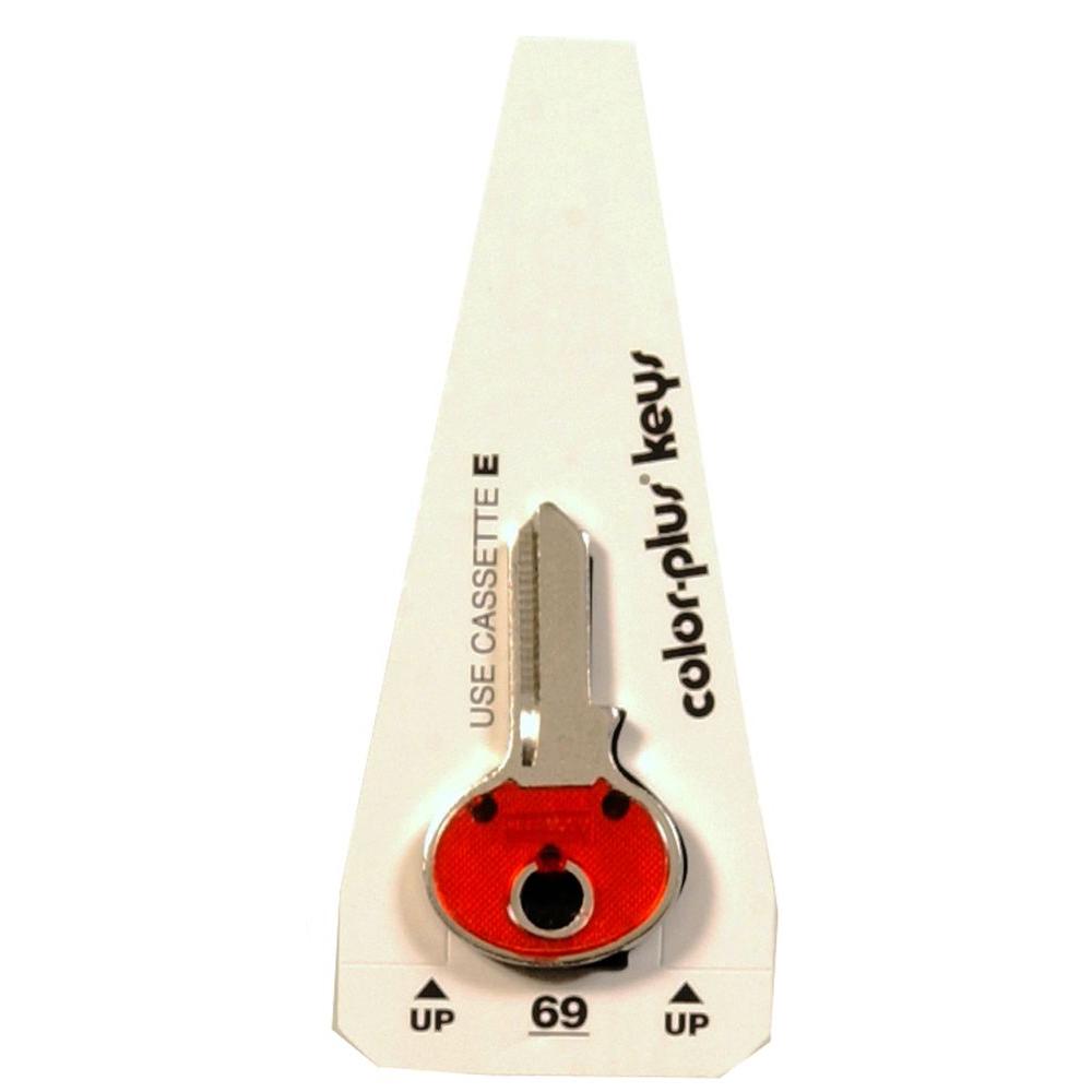

I don't have a key for the R80 but I have found a key that fits it. Based on that, I purchased 5 blanks (Hillman 69) at Home Depot. Here's the key blank: https://images.homedepot-static.com/pro ... 4_1000.jpg
I also have a handful of MiniCo C70's. Don't have a key fir them either but the same Hillman 69 fits. So... I may sacrifice one of the C70's to get to the core and see what the pins measure. If they yield something close to the Masterlock bitting spec (https://cdn.masterlock.com/masterlock/r ... _pg_25.pdf) then that might suggest I'm working with pin specs that are viable.
