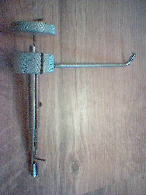

a 5 lever without a barrel and curtain (if you look in to the keyway and see a silver or brass thing ) same as 2 3 lever but these lock may have anti pick notches.
if it has a curtain it may be possible with two wires but easier with a curtain pick likc this Image
picture taken from safeventures
or thisImage
