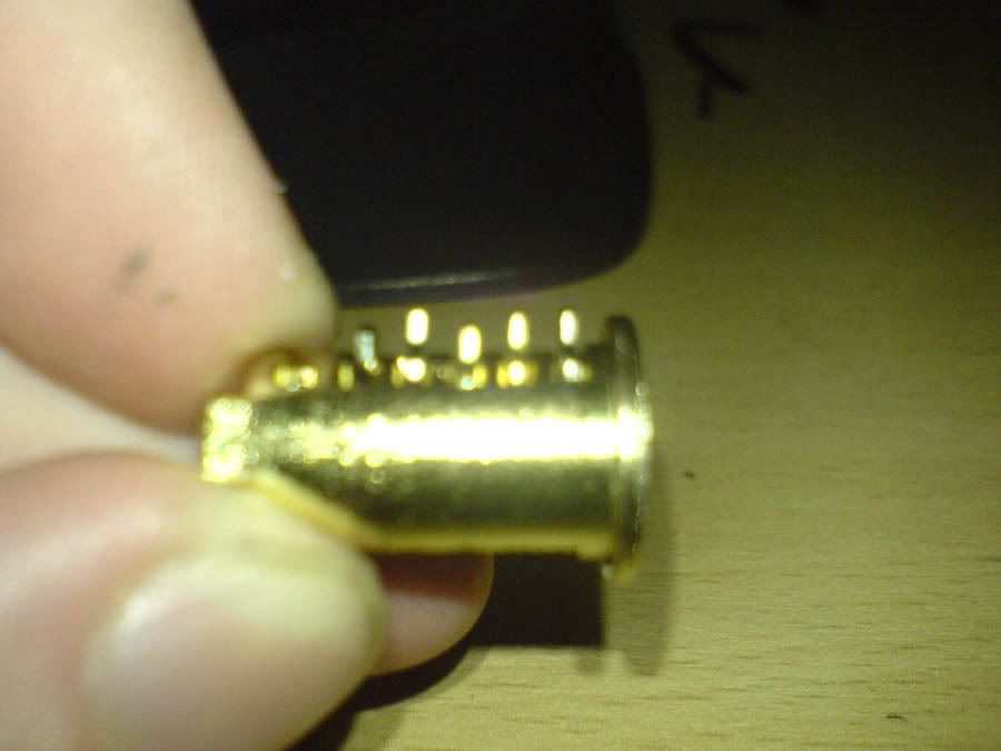

How would u take apart this lock. Keeping in mind they i would still like it to look fairly normal.Its just a simple wafter lock i think. I took it out of a desk and would be interested to see how it works.
Heres some pics.

You will either have to pick a wafer at the back to release the plug or drill out the rivets holding the plate on and undo something on the back of the plug,
It is a regular wafer lock and i wouldnt bother damageing it it you have to as its simply nothing interesting inside,

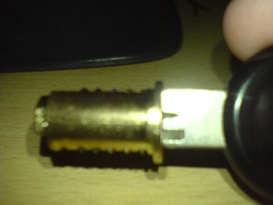

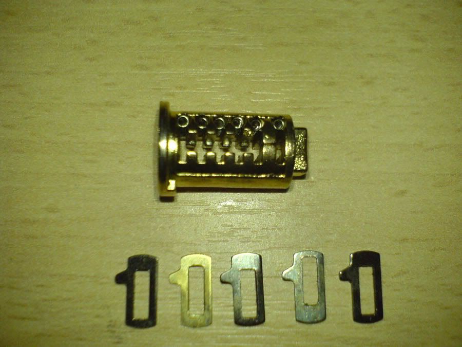

Thats just like the lock I took apart.Shrubs right drill out the rivets, then you should see a little piece of metal on the back of the cylinder.Push this down with the key in or pick it and the cylinder should come out.
Heres some images of the one I took apart.
The first one is of the wafers themselves and the cylinder beside them.

The second is the cylinder with the wafers in.But without the key.

And the third is the cylinder with the wafers and key.
http://i150.photobucket.com/albums/s116 ... ithKey.jpg
Sorry about the quality of the second and third images.
Hope this helps.
