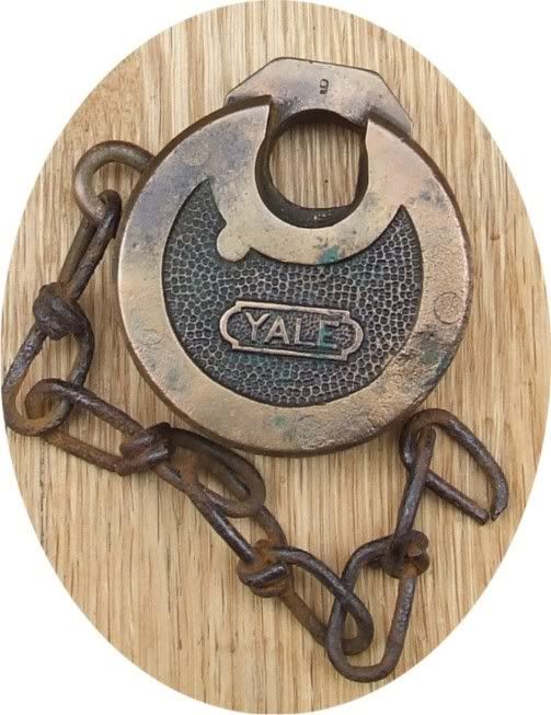

We've got this Yale Padlock in our shop:

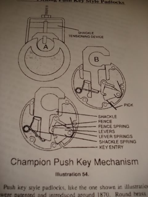

We're trying to make a key to it. Once picked, the levers can be impressioned, as they are held in place. We have advice and tech tips on how to pick it, including drawings showing the internal workings.
So far we have had no luck.
If someone in the Markham/Toronto area in Ontario, Canada wants a challenge, send me a message.

Push key
Postby raimundo » 21 Sep 2007 7:57
I would not put that antiques shackle in a vise just to pull on it, put a piece of thick hemp rope through the shackle and put the rope in a vise or on a doorknob or whatever.
that has a key that just pushes in the bottom of the lock,? this has the lever cuts on the end of the key and it goes to the bellies of the lever and sets it up. It could have as many as 8 levers, or as few as 4, with and inspection light, you can see the bottom of the levers through the keyhole.
I would not try to dissasemble it, even if you cannot pick it, its more valuable as a classy paperweight if its untampered with, and it will remain a challenge for someone to pick impression it. A paperweight with mystery see!

One of the techniques is to pull on the shackle which will put pressure on the fence and be forced against the levers. As you pick, the levers (6 in all) should bind and you can feel the gates. Once all the gates are lined up, the padlock will open and the levers will stay in place, allowing you to generate a key. In theory. We haven't had any luck so far. The instructions do say that later model padlocks do not work this way, so that may be why we haven't had success.

Postby I Pik U » 21 Sep 2007 8:09
Here are some pix from the technique, using a puller, which we've tried, also with a spring on the puller to give some pull force as sugested:
