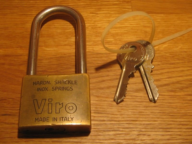

yesterday evening I tried both SPP and raking but nothing worked.
I opened it once but I couldn't repeat the process so I think I was just lucky. I try to describe what happened. SPP as usual, after about one minute I thought it was open cause all the pins were set, but I couldn't rotate the plug. Then, without moving the wrench, I tried a very gentle raking with the back of my hook and it opened. I tried it again and again but nothing worked. I also tried raking it but usually I don't rake, so I'm not very good at it. After 15 minutes I gave up.
This lock is an old brass VIRO... I can post here a picture, maybe somebody could help me to find out if it has any security pins. I don't want to drill it.

Here we are, so you can see if our locks are similar...
Does anybody knows if this lock contains security pins? There aren't numbers on the lock so it's very hard to say.

We have pretty much the same looking padlocks here. I have recently bought a new one:
And it gives me some hard time for it's very difficult to find the binding pin (situations like "Oh, that was a binding one?" when you just push them down randomly) and makes me feel that serrated "turn back" feel on the tension wrench. So I think that although these locks are cheap and small, they probably contain some security pins. Anyway, I'm probably gonna go ask my local locksmith, he may have some further info.
For me personally, the simpler lock the harder to pick. I am able to pick standard cylinders in no time, while old cylinders and padlocks are very difficult for me.

try a little oil on those old ones :)

Finally I got it open!
raimundo: I haven't tried oil with it cause I've already oiled the other "twin" lock and I wanted to try a different situation. You was right: the problem with this lock was the stiff plug. When I set all the 5 pins it's hard to turn it. A little friction between the wrench and the cylinder or some dust inside the lock is enough to block it.
Also the pins are harder than usual, but now I can say how much I need to push them to set them.
It was an interesting experience, but now that I picked it many times I can oil it. I don't want to learn bad habits from this stiff lock.
