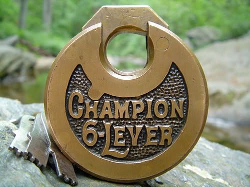

Anyways, the other lock has me stumped. On it, it mentions "CHAMPION 6-LEVER", and has a flat slot on the bottom of the lock.

So 2 of the locks you have sound like warded padlocks, they are pretty easy to open as you've observed due to the fact an "L" or "T" shaped implement will usually push the locking dog or latch across, releasing the bolt. The 6 Lever will take a bit more than just that.
So if it really is a 6 lever padlock you'll want to learn how lever locks work. I've never seen inside a lever padlock but on mortice lever locks essentially a stub attached to the bolt holding the mechanism closed has to slide through the various gates in the middle of the levers. The gates in the levers are lifted to the right place by the key which then goes on to throw the bolt.
To pick, you apply tension to the bolt, pressing it in to the levers which are then manipulated with another tool, either one by one or by overlifting the whole lever pack and jiggling them down to the gates. Like pin tumblers the levers will bind whilst being tensioned and so long as enough tension is there the appropriate binding lever will hang on the edge of the gate allowing them to be placed one by one. There may be false gates on the levers to make things nice and tricky.
It looks like all I've said might not apply, however because your lock looks a lot like the one in this picture:
If those are, indeed, the keys sitting by it then I have some musings on what might need to happen:
It almost looks as if simply pushing the key in up to the stopper sticking out of the side would release the bolt or in case, the shackle. So if you apply tension to the shackle and push the levers in the appropriate distance, it should pop. My thoughts follow this direction because on the keys pictured, you have 6 depths, (high, low, high, low, high, low) along the end of the key which would make sense given it's "6 Lever" logo.
Anyway, I stop rambling now, good luck with that, hopefully someone will chime in who knows what they're talking about. :)

Olson Burry wrote:Hello, welcome :)
Maybe it works like early French Fichet pompe locks?

Postby Jaakko » 21 Jul 2009 16:35
You can't tension that lock by pushing the shackle, the mechanism locks itself if pushed from the shackle. Check graymans book "High Security Mechanical Locks", it has a nice diagram of the said lock :) Or search Google Patents.

Postby raimundo » 23 Jul 2009 8:41
Google Miller Push key lock to find out more about that. Perhaps at Oldlocks.com or antique locks.com

Postby Fredmad » 23 Jul 2009 10:55
I think you have got the same way to open it than on this link.
http://www.youtube.com/watch?v=SVofergXgKM
Perhaps to be sure the better way is to disassemble the lock to see how the different components work.
