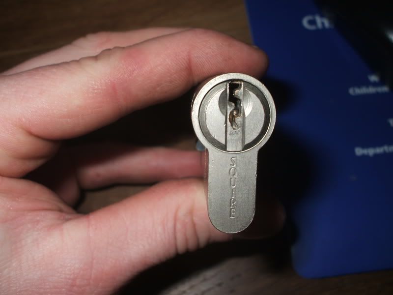

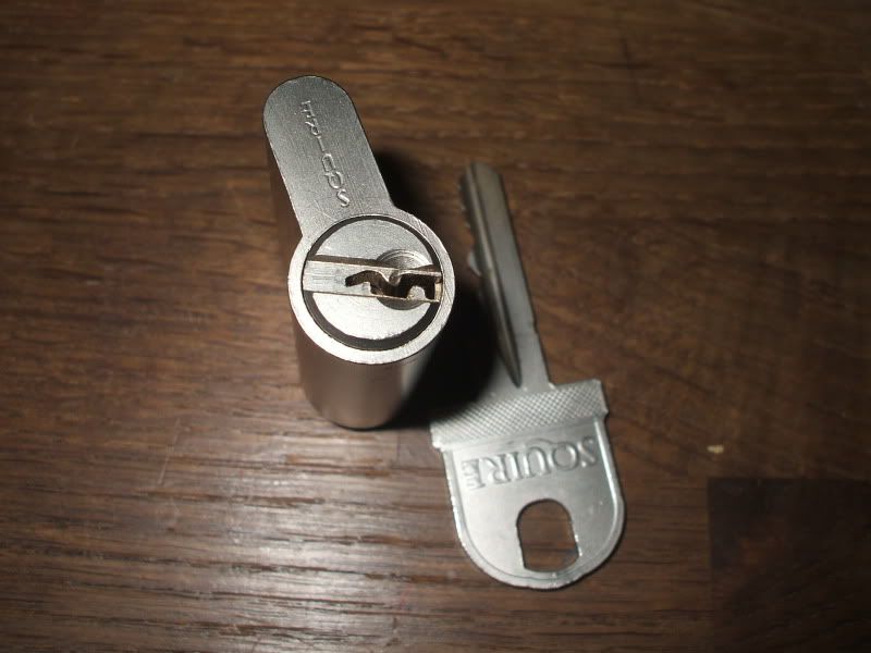

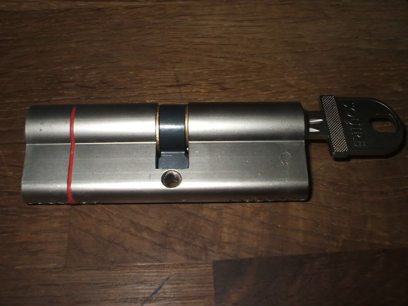

First time iv seen one of these squire euros and its a pretty tough pick
Anyone got any inside pics... or am i gonna have to dismantle it :mrgreen:

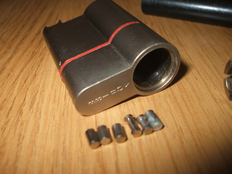

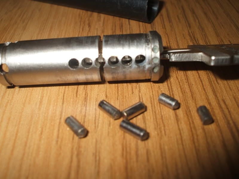

nothing special at all, just a well made lock.
why the two lengths of spool pin though?.. seems strange

I´ve got the same lock, got it from Sks-keys.
It´s the only cylinder that I have, but cannot pick.(exept for some assas and abloys)
The keyway gets really tight if you need to pick a high pin. I dont want to bend my hpc deforester that much.
Thanks for the pictures of pins, Rick. Those don´t look too hard.

The spools require quite a bit of force compared to other locks

I think the shorter spool is for the longer bottom pin, and the longer spool is obviously visa versa for the short bottom pin.
Maybe the pin chambers aren't tall enough to accomodate the long bottom pin and long spool pin with the spring? I've found that if i put a short bottom pin and a short top pin in some locks, it is below the sheer line.
