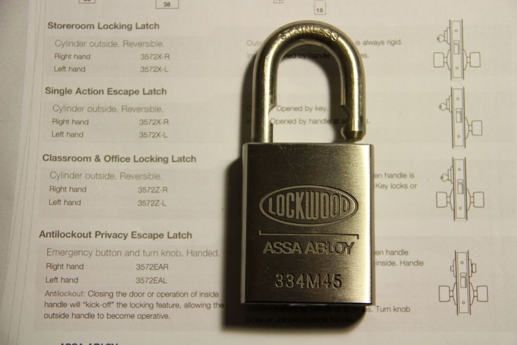

If you were over this way, I'd recommend a Lockwood Marine style. You might be able to find some your way if you can't find anything else suitable.
Stainless body and shackle.

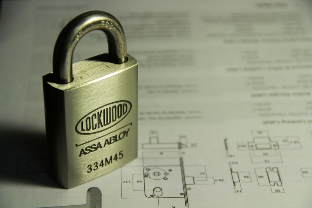

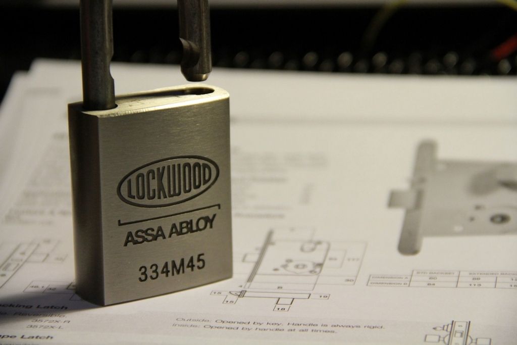

Looks even better when it came out of the packaging! but still looks pretty good for being outside for about 8 months. The only bad thing about these is that they don't come with security pins, pretty easy to rake open and etc. But they do take a variety of restricted plugs, and security pins so I'm not too worried.
The abloys you can find cheap sometimes, they come up every now and then. The 330s, 340s etc are all steel with boron shackles but the chrome plating seems very very thick, they have drain holes on both sides of the shackle. They also have the 341s which are brass bodied with a chrome plating, and as others have said the abloy core is pretty good for tough environments.

Postby jimu57 » 4 Jul 2015 7:07
THAT one in the pic has been outside for 8 months??? Looks like it came right out of the box.

Postby Michelin Man » 4 Jul 2015 21:28
Yep, give or take a couple weeks. Then again it's not exposed to salt water, just the constant sun and rain every now and then. It has stood up better than my other padlock I've had on there.
The brass lockwood (much used) I had on there the shackle would rust up immediately and get slightly sticky so the spring wouldn't push open the shackle. The cylinder and locking mechanism was fine though.
