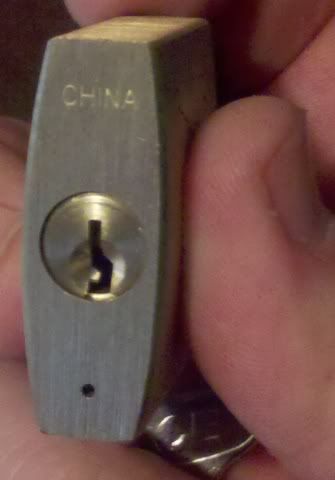

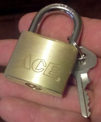

Well, much to my chagrin, it does in fact say "China" on the bottom. But dang, this lock has given me problems!! I'm about to try that overlift thing - is that basically turn the pick over, lift the pins as far as you can, apply a lot of tension, and gradually let it off, trying to set pins as you release?
Here are two pics.

Re: ACE Hardware padlock...owning me
Postby Oldfast » 26 Mar 2011 21:56
chriswingate wrote:I didn't know Ace Hardware locks were made by one of those two brands. Good to know, thanks for mentioning that.
+1 on that. Thanks for that little tid-bit Squelchtone. I had been wondering about that myself.
TastyCat, just wanted you to know your not alone :D I had purchased one of these a couple weeks ago, tried it a few times (with no avail) and it's been setting there ever since. On the up side I thought " at least I'm getting a run for my $. At the same time kinda frustrating though- Why can I open all the brass #'s from both Master and Brinks and not this? It looks to be exactly like yours. It might be the next size up, but still a 5-pin with CHINA on the bottom.
Your post prompted me to give it another try. Over an hour later, still nothing...then finally... I've now popped it several times in the last few minutes. But not without learning a valuable lesson: Don't get stuck in your ways! My preferred method/approach with most locks is a 5-6'' tensor used at the top of the keyway, along with various slim-line hooks or deforest picks.
My lock is all spools except for the standard driver on pin 2. It sets first giving me a false set at about 1:00. But from there I had a hard time setting other pins without dropping that first one, but was certain I had the correct order. Long story, short, I ended up going against all my instincts and tensioned from the bottom with a stiff 3" wrench and used a medium 1/2 diamond. This, for me feels very un-natural and tight. But immediately, I was able to set the spools one after another without dropping the last. Light to med-light tension.
Note: I noticed your first pin sets much lower than mine, so this may or may not help you. Either way, I learned something new tonight, so thanks.
