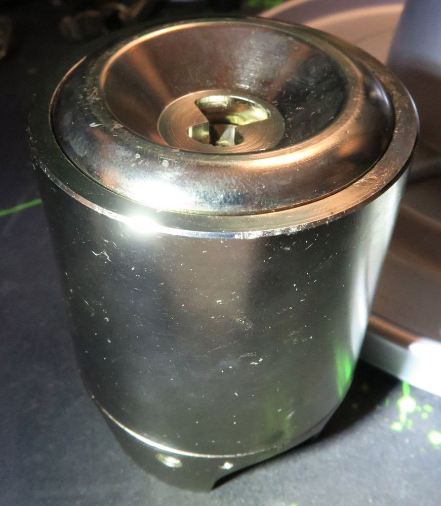

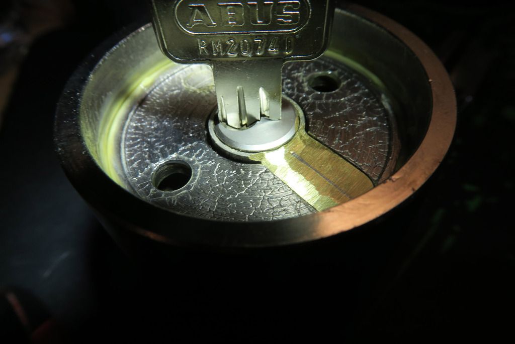

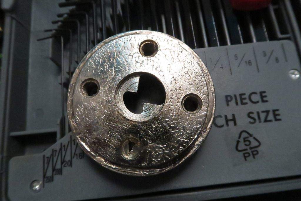

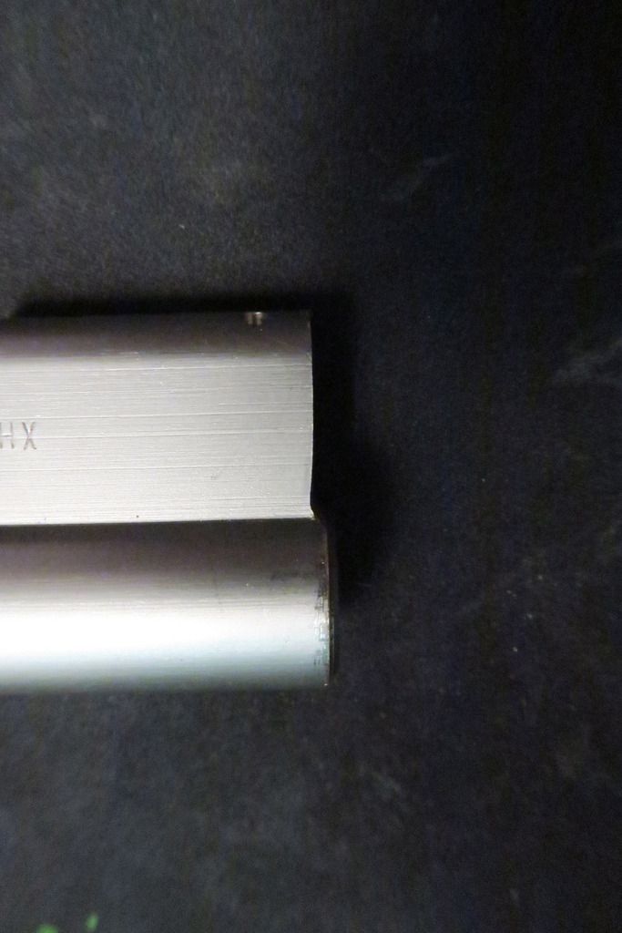

Now, let's come to my lock. This is the front of the Euro cylinder (Abus E60) that came in mine:
As you can see, it has been filed down on the front portion of the cylinder. See that silver line in the middle of the brass filing? I thought that was just the old silver finish of the lock, i.e. that the Euro has been filed slightly from both sides but left a small area of the original Euro front unfiled. Actually, upon further examination this appears to be a hardened anti-drill pin which has been partially filed into!
Here's the front from a side-on view:
You can see that the front face has been filed down a bit. This is because the front plate only has a hole for the round part of the Euro, not the bible:
And thus when the lock is fitted together, the round plug part of the E60 Euro squeezes very tightly into the round cutout in the bottom plate, and the filing back of the Euro allows it to fit without the bible pushing it back out of the hole, if that makes any sense. Note that Bill's one did NOT need this (either the chamfering or the filing down of the bible) for some reason, even though his bottom plate looks the same.

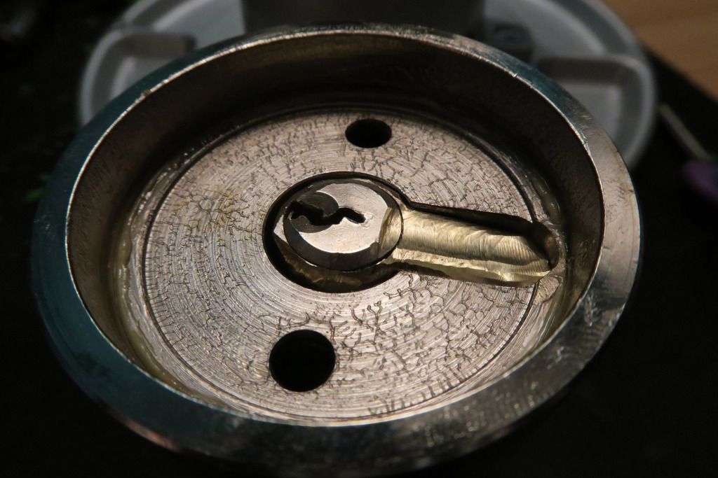

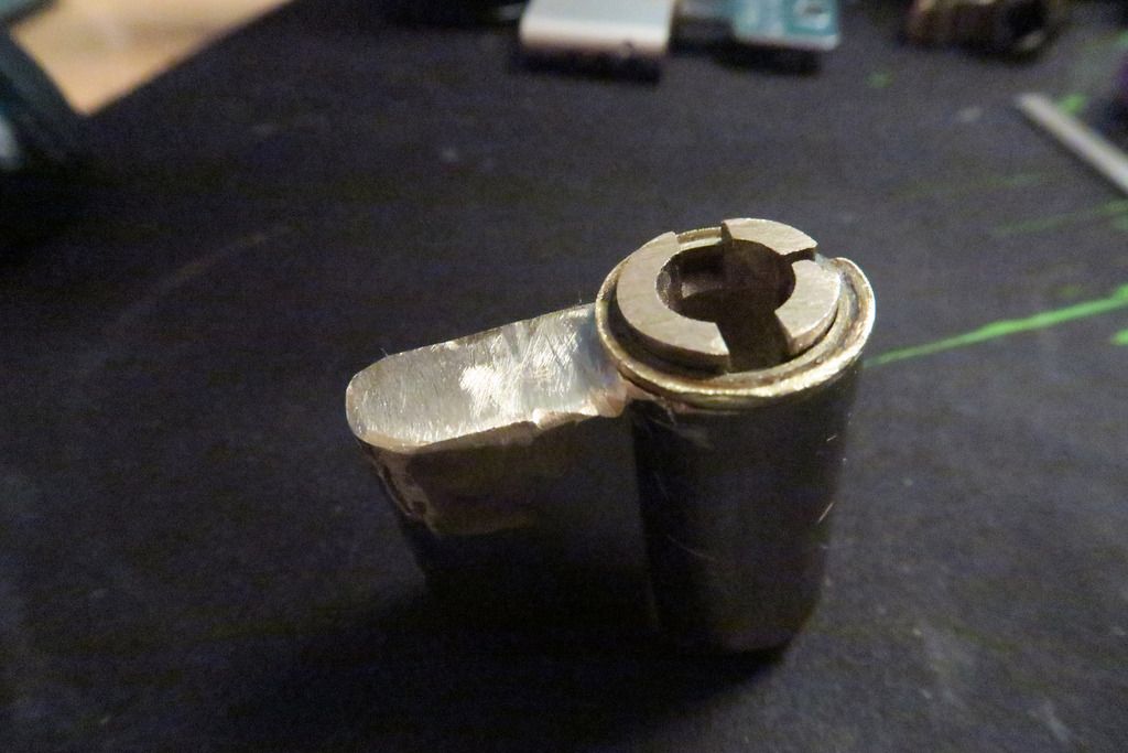

Moving on with my lock, here is the back of the existing cylinder:
As you can see, both the bottom has been filed back and not only that but the round actuator part that fits into the cam has been as well. Again, Bill's one had the bottom bit sticking out of the back so I can't imagine this is a problem with all of them for some reason and I'd imagine his Mul-T-Lock didn't have that actuator part filed down (although I can't imagine how the actuator part on his could reach the lock actuator bar at the back of the lock with that bottom part "in the way", but surely if he cut that part off, and the lock was flush before, it would now be way too short with that bottom part cut off? Sadly he never shows this so there's no way to know).

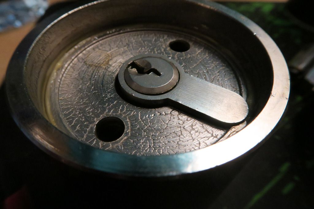

Here's the original Abus cylinder in the lock, sitting flush. Note that the front had to be filed down in order for it to fit:

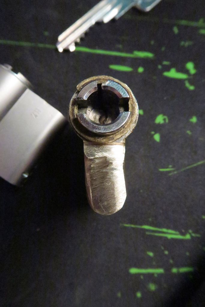

Here's mine before I filed the actuator part, clearly sticking out:

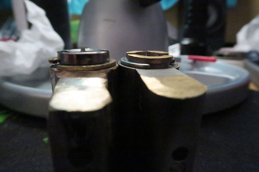

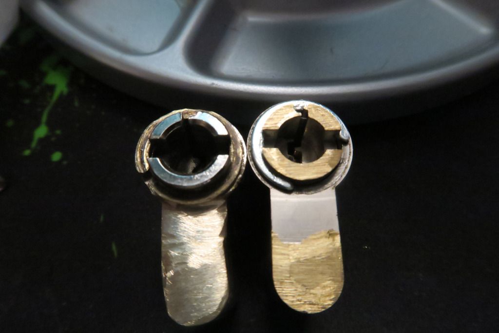

Backs next to each other, clear that the actuator part had been ground down on the Abus:
This is when I realised the heights are different on the actuator. On the right is the Abus; on the left is my cut down double Euro:

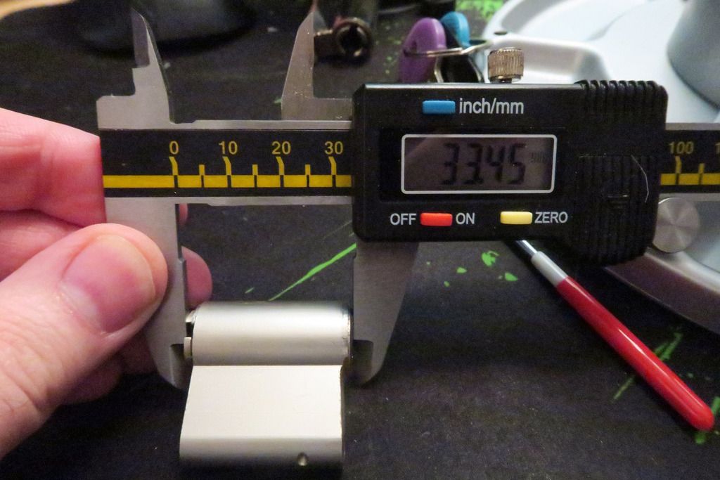

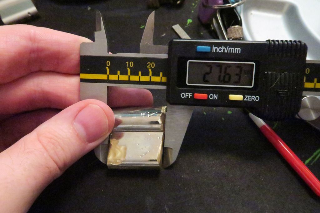

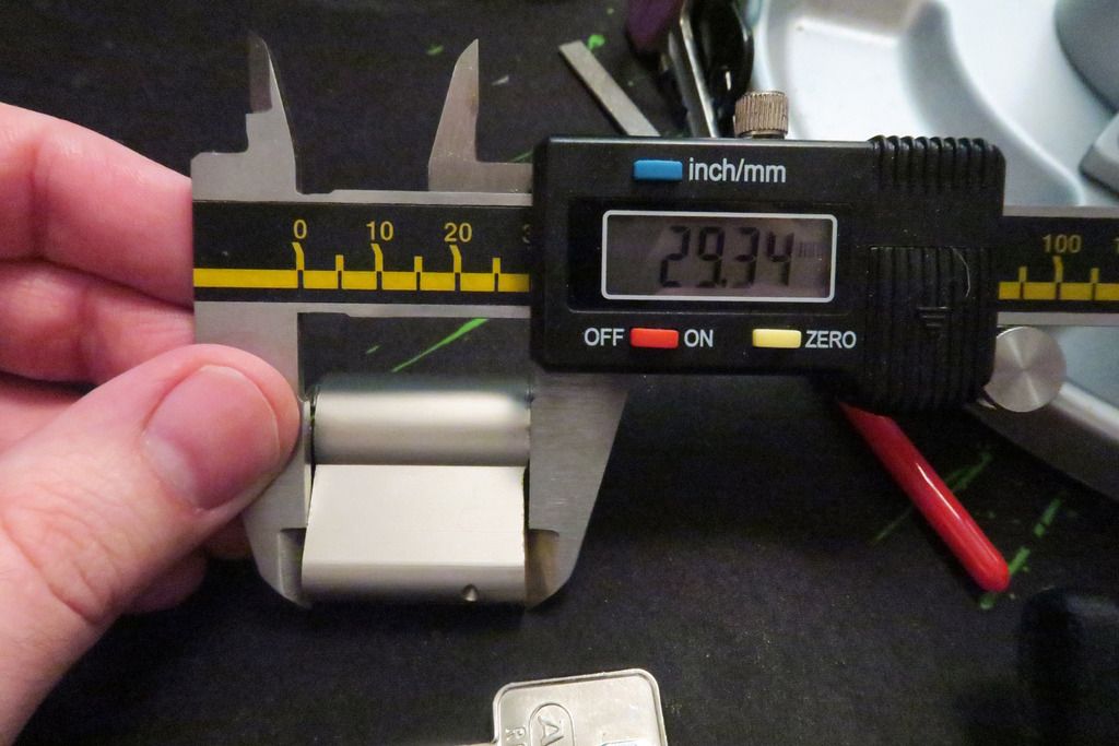

The bible of the original Abus sylinder measures 29.34mm - clearly 30mm before it had been filed down:

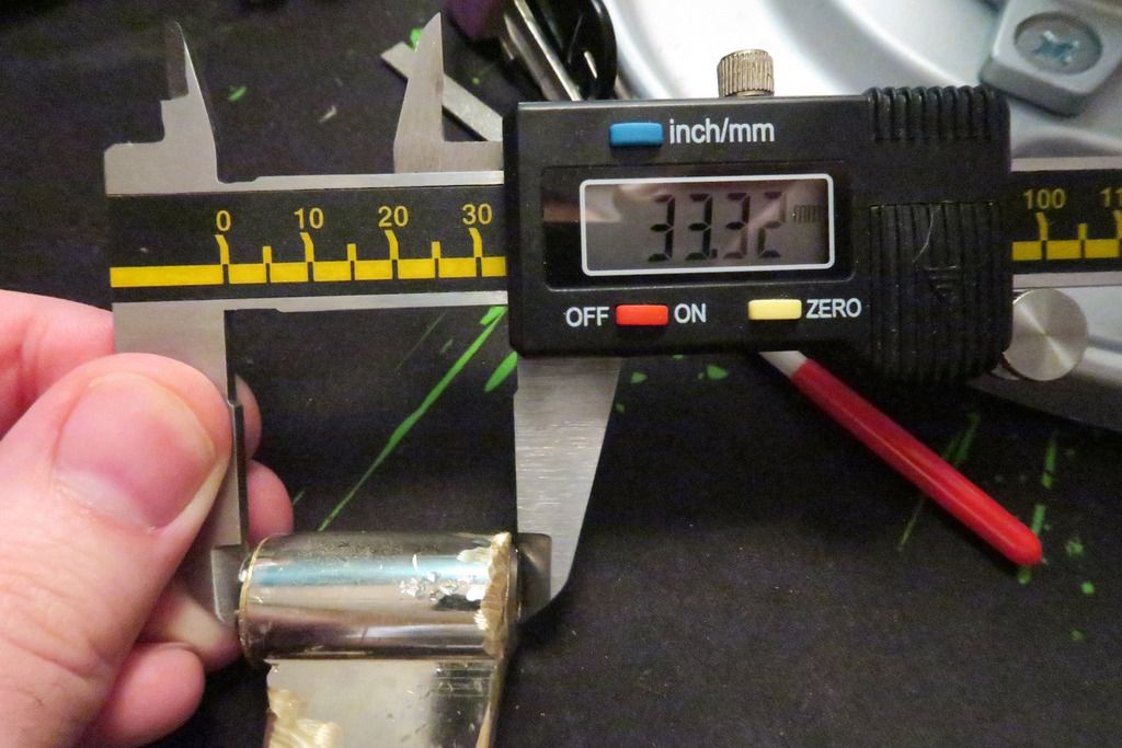

Here's the measurement of the round part, at 33.45mm - again, I dunno what part is actually measured for Euros:

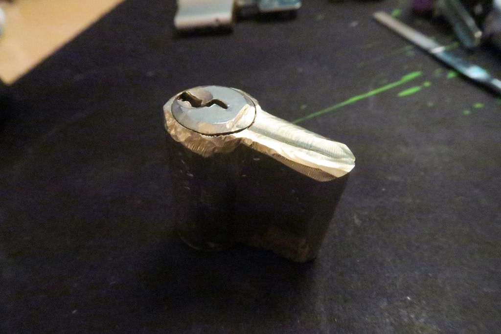

Here's the round part of mine after I'd filed down both ends (before filing off the actuator parts it was around 2mm deeper) - 33.32mm:
And the body at 27.63mm (took a LOT of filing to make this fit):
The front of my new cylinder after I was forced to file down both the bible and the round part edges to fit into the front plate:
Note that even at this stage, the round part was now too narrow to fit into the bottom plate round cutout (now loose and floppy rather than perfectly fitting, as with the Abus), and I never managed to grind down the front enough to allow the cylinder to sit flat rather than at an angle.
And the back:
I did manage to get mine to fit flush into the lock eventually:
And it can be closed:

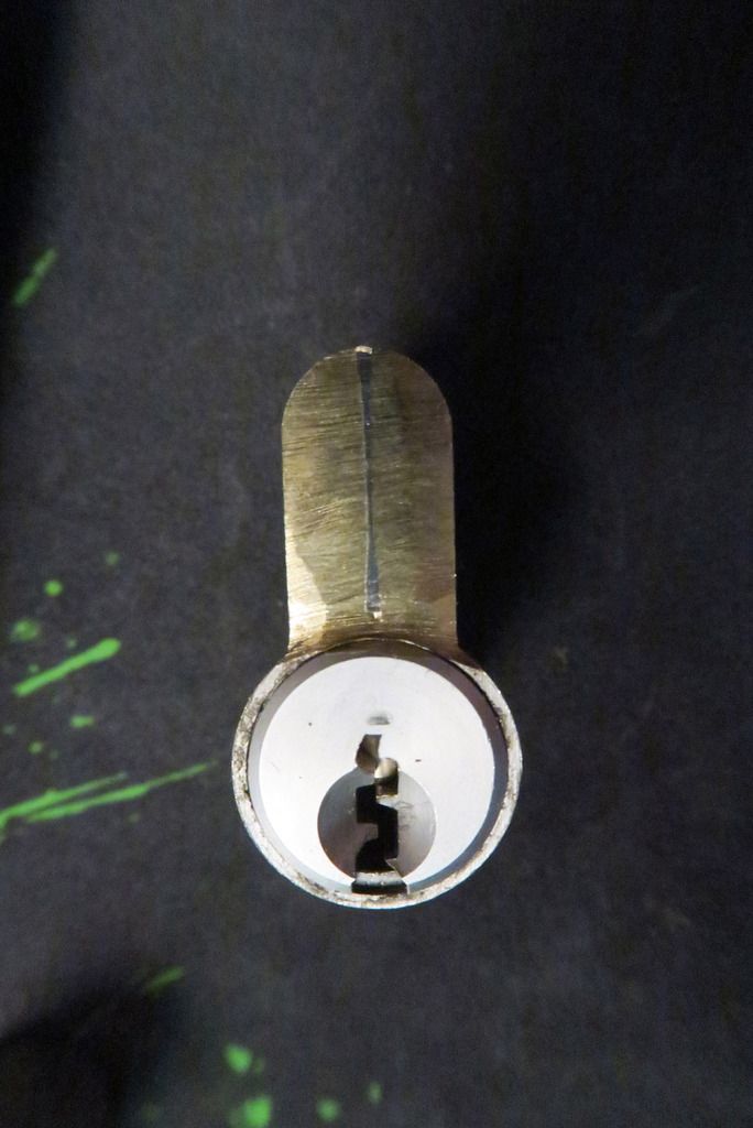

Postby jimu57 » 17 Jan 2016 22:13
LocksportSouth
A few pics
http://i.imgur.com/GsIVHwk.jpg
http://i.imgur.com/i8edb25.jpg
http://i.imgur.com/QzfhHH8.jpg
http://i.imgur.com/vxEOIo3.jpg
http://i.imgur.com/XPep3cR.jpg
http://i.imgur.com/yv4EwUG.jpg
You can see, I havent made any modifications to the cylinder. It is the same as in the video.
