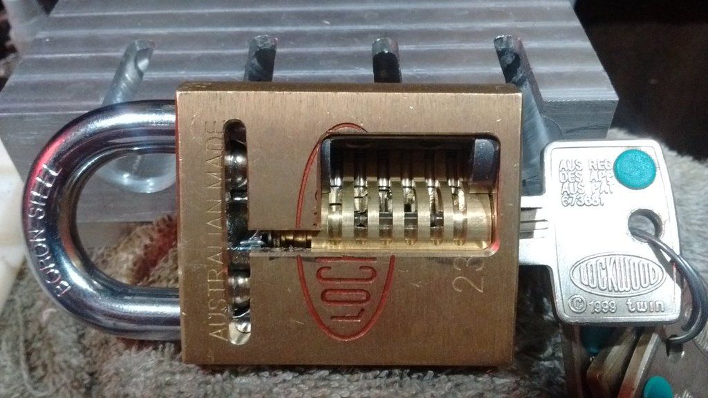

Re: Some Cutaways I made
Postby blue60 » 4 Mar 2017 22:42
another Lockwood

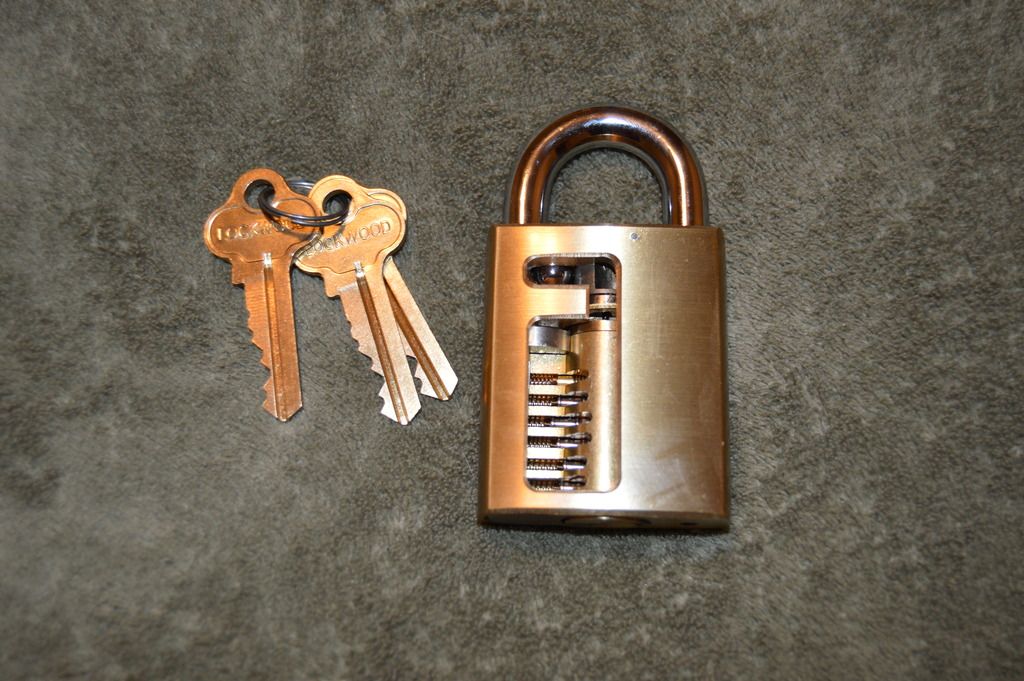

Postby adi_picker » 5 Mar 2017 20:06
Nice work on the Lockwoods blue! I think they look much cooler with the larger bow restricted key as in your second photo here :)
Postby blue60 » 6 Mar 2017 13:38
Thanks adi_picker I agree the large bow key give it a little something extra.
here is video of the Lockwood ;)
