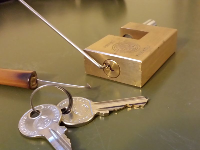

Postby femurat » 9 Apr 2014 4:31
Got this nice ALA padlock and had quite a hard time picking it for the first time. I had to find a tight fit tension wrench that didn't slip away. Notice the top of keyway is mirrored and the tok wrench slips away due to the orientation of its angle. I had to force the tension wrench in the bottom of the keyway but I keep it towards the center to avoid it binding against the cylinder wall and preventing it to turn.
The padlock is key retaining and the shackle is pushed out by a strong spring, making tension control much more challenging than usual. Pushing the shackle in to reduce the spring tension didn't work so I had to use heavier tension than usual.
I underestimated this little padlock. All in all it was a fun pick.

Postby KPick » 14 Apr 2014 0:52
Is that a bamboo wrapped pick?
KPick
Posts: 623
Joined: 6 Jun 2013 22:13
Re: What did you pick today?
Postby femurat » 14 Apr 2014 2:02
Yes KPick, it's my favorite one. You can see it here in the making and finished on next page.
Postby GWiens2001 » 14 Apr 2014 23:34
Funny... it looks just like my favorite dimple pick! ;)
