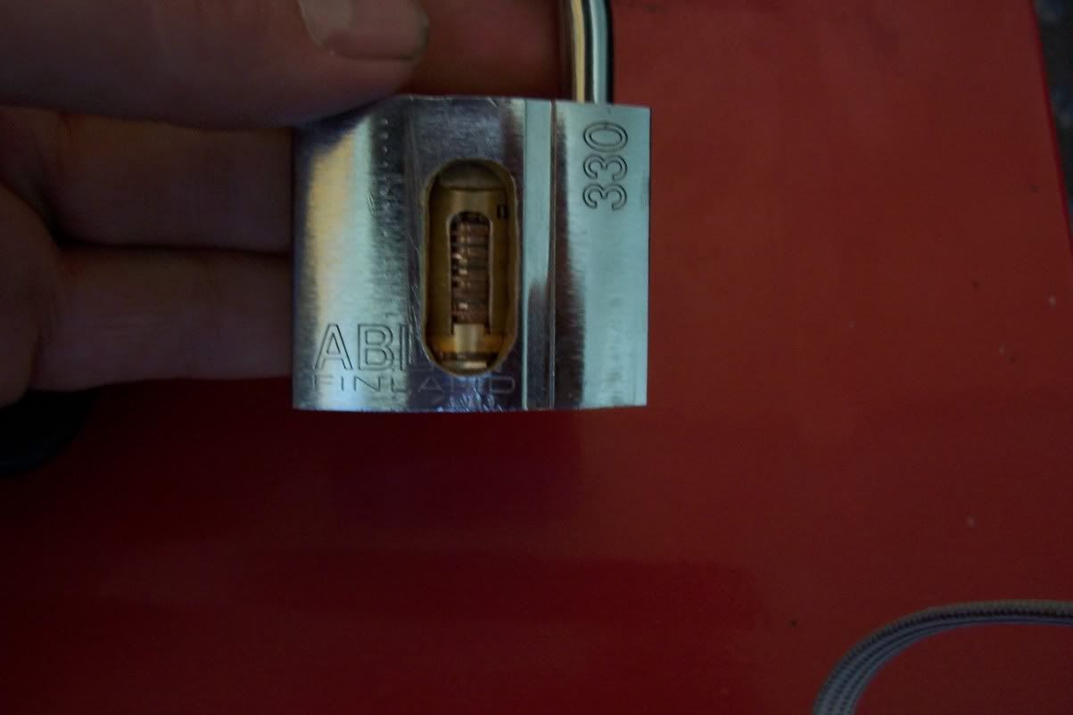

by skold » 18 Nov 2005 22:07

by Mad Mick » 18 Nov 2005 23:12
skold wrote:Ok... I got off my arse today...
Good effort!
Nice cutaway skold.
