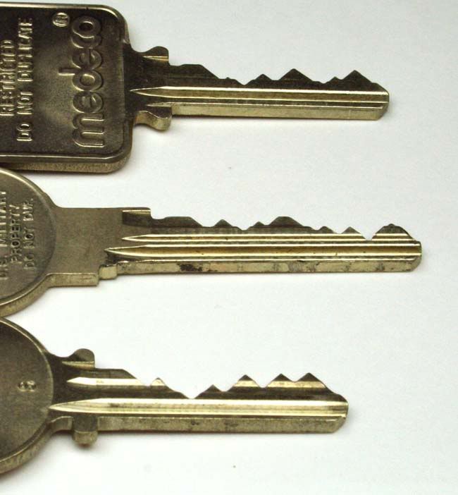

Postby zeke79 » 15 Jun 2006 19:39
Top 2 are biaxial, bottom is standard. You can see the spacing differences made by fore and aft cuts.

Postby zeke79 » 16 Jun 2006 8:00
Note the odd spacing between some cuts on the top two keys that is not present in the bottom key. Some cuts are closer together on the top two keys and some are spaced far apart while the bottom key keeps a standard spacing.
Postby mh » 16 Jun 2006 8:01
Shrub wrote:I have to say i dont fully understand what im loking at here, i see the 3 keys of course but dont quite understand the differance you are pointing out unless it is the little cut on the blade at the bow side.
The 2nd "axis" in Medeco "bi-axial" refers to the pins. That means, each pin has to be at the right 'height' for the shear line, as well as at the right 'angle' for a sidebar to drop into a cut in the pin (there might be "false gates"/cuts as well).
The end of the pin is therefore not round, and the key cuts are made at angles that are not necessarily 90 degrees, usually not.
And that is what you can see in the picture of a key.

Postby zeke79 » 16 Jun 2006 8:08
mh,
What you just described is the rotating pin pricinipal. The biaxial system uses a fore and aft cut system to increase key differs if I am not mistaken. That is what is represented in the pictures. All medeco locks utilize the rotating pin principal, biaxial or not.
Postby devildog » 16 Jun 2006 8:11
I thought that 'biaxial' indicated the rotating pin system, and that's it, now it seems to simply be a keyway like 'schlage C' or 'Best FM', so now I'm really confused!
